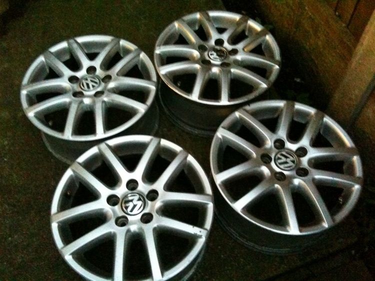

Does anyone know what wheels these are called ?
Standard gti 2.0 115bhp 2000 w reg

http://www.4130-products.com/wheels/
Here's a large list of VW wheels, perhaps you find the correct ones..
I had a look but I couldn't match any exactly to the picture you posted.

I think they are from a Polo, for some reason Polo's have stayed with 5x100

Only asking because I've been offered these for a swop for something but before I swop I want to make sure they fit my mk4 think he said he used them before on a sheran I've asked him what the stud fitments is but not heard yet

Sharan is 5x112 so will not fit a mk4 unless you use adaptors.

Spacers are to expensive , just got a set montys 2 on eBay got them for £130 got to pick them up Friday is that a good price for these ? Wanted vw alloys as don't wanna change my wheel nuts
