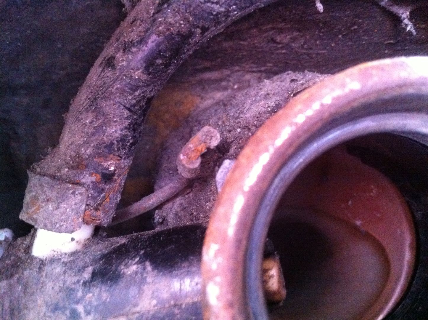

Took the rubber surround of the petrol filler to clean and check for rot and found this stray wire (between the pipe top left and filler bottom right in picture) going to nothing.
It has a femal connector on the end and looks original,my guess is it's an earth but I can't see anywhere for it to connect ,cars a late 92 8 valve if that makes any difference
Any ideas !

earth strap according to etka.

I thought it would be an earth
Can't see anywhere for it to attach it must have rotted away I suppose

looks like there is a metal clap around the tank neck that one end fits to - but can't see where the end goes but I would assume the body at some point..

Its an anti static "Ground" for the filler neck, these would fall off after the car was less than ten years old, so really wouldn't lose any sleep over it... OTT attempt at eliminating a spark while filling up with fuel, and you've already grounded the car when you pull the filler flap open...

Ok thanks guys
I think I will just leave it where it is
