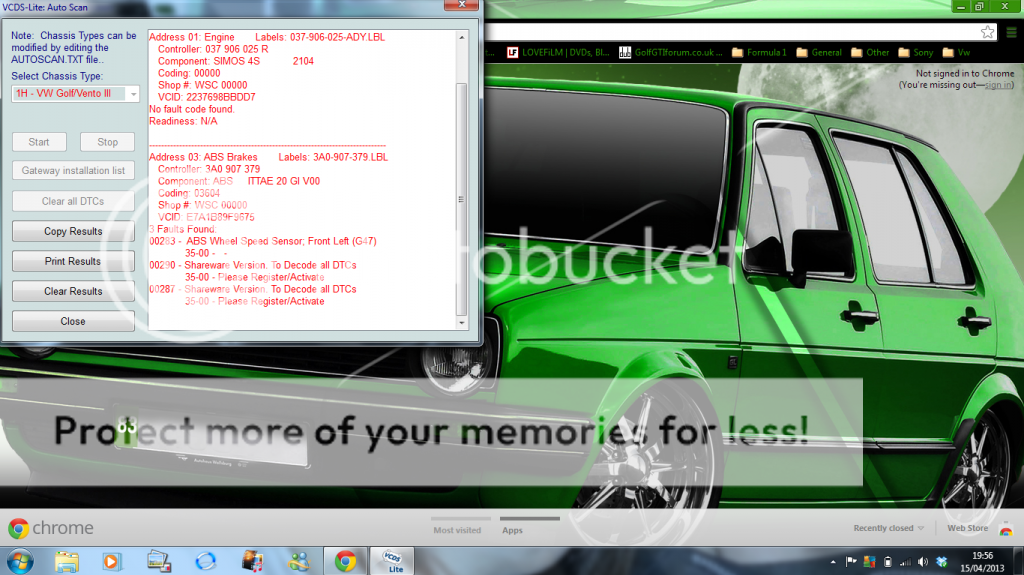

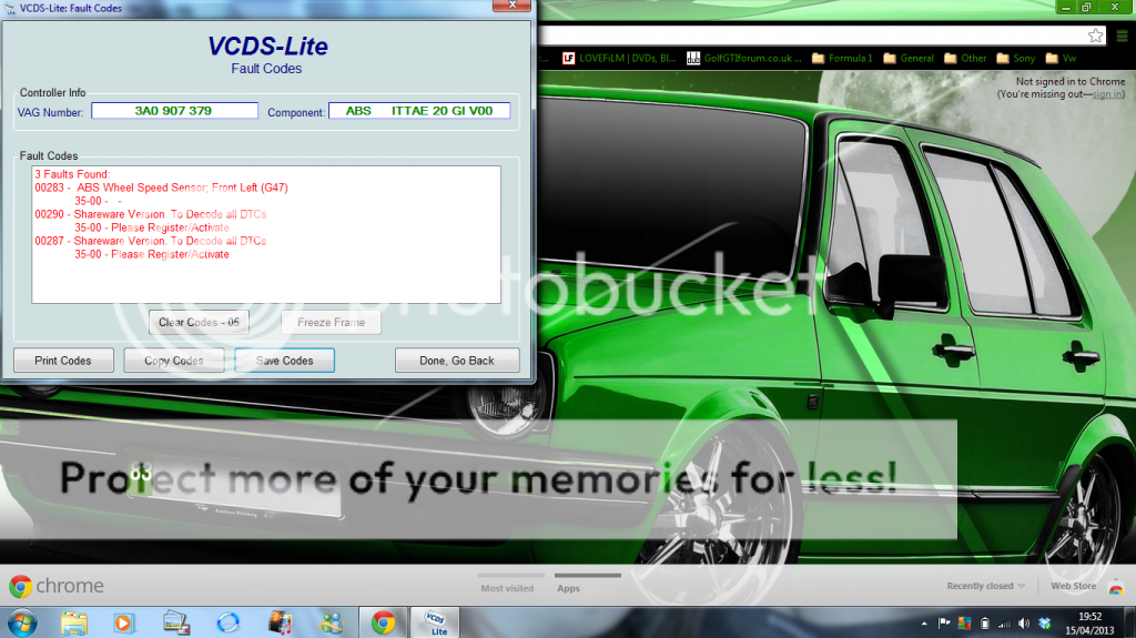

well looked into it earlier tonight and removed the airbag/abs warning light module and unclipped apart so as to check for the suggestion of the abs bulb being blown (thanks for that advise  :wink:) and when plugged in airbag bulb illuminates and no the abs one doesn't  :grin: so after getting the part number and not even ringing vw as i know they can be up to £100 !! i found a 6 pin unit on e-bay  :wink: 1H2 919 235T mine ends in s but apparently 'T' replaces this part,so will use the bulb unit from that  :wink: also re-scanned tonight for fault codes after wiping them and here's whats come up:-
Well looks like the airbag code was due to battery disconnection and only one sensor seems to be at fault so will fit a new sensor and see what happens  :laugh:
