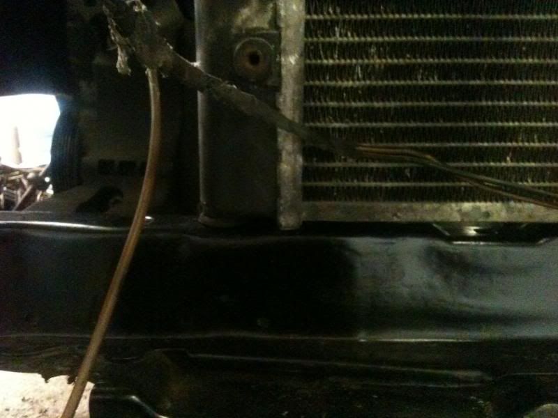

Ok not a massive update but i have managed to plum in the whole water system and fit the radiator in its new home, just need to mount the expansion tank or fit an in line filler.
How the rad sits now nearly the same but just had to drill a few holes
The original mounting points i kept the same
Then drilled a new hole at the bottom where i have moved the rad over to allow for my intercooler pipe work notch
Just need to make some sort of fixing for here
Then the top pipe was made up
