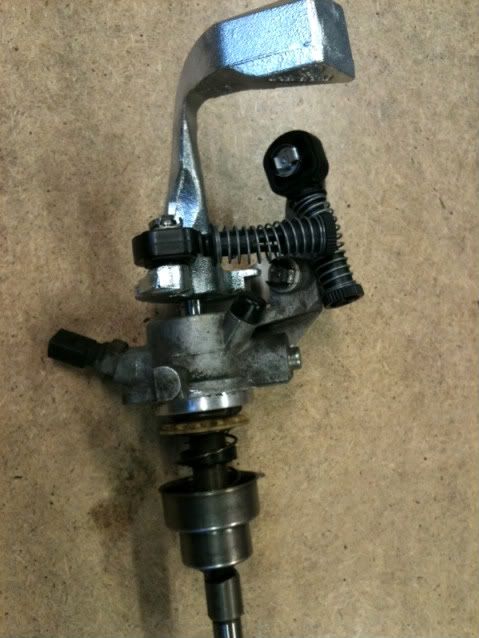

You need the mk4 02J shift tower. Not the early type that's similar to a mk3.
You may have to rebuild it if the bearing is loose. You can use the later type of relay lever and a TT short shift if you like. These parts come with newer style Bowden cable clips.
 You can modify a mk4 shifter to fit, Or may be easier to fit a polo/Lupo/Ibiza one.
 I used mk4 cables and cable bracket with an ibiza cupra shifter. You just need to drill a hole an fit a bolt to the front of the housing to fit it nicely.
The rear bolts up to existing mounts in the tunnel.
Shows mk4 and Ibiza shifter comparison. I used mk4 cables.

I just used the MK4 shifter from a Gti, the box is bigger so the under side of the car needs modification, we had no issues with this but it may be too much for some folks to take on
Tshirts way is easier to do as less modification to the cars shell
Also had to cut quite a bit off the shaft as the gearstick was way too high, the MK4 must mount lower
