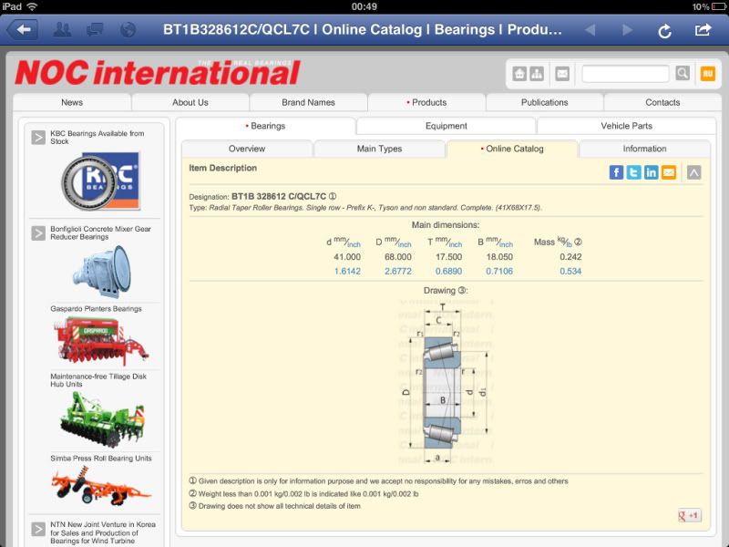

These are the bearings that have been removed from the diff casing, 90% sure the options on ETKA were 16.5mm and 16.6mm, which clearly don't correspond with anything on here.
We have given it a go over with digital vernier, and the closest figure, 17.5mm seems correct. I guess ETKA wouldn't be out on the sizes for both bearings either.
Hopefully my memory has served me incorrectly, and it was indeed 17.5mm on ETKA. Pretty damned sure I'm right though.

Have the SKF bearing came out pictured about but it has no 16.5/6 measurement that matches up with anything.
On ETKA it's actually in the Diffrential bit itself, have the part number, just need to know which one to go with :afro:
