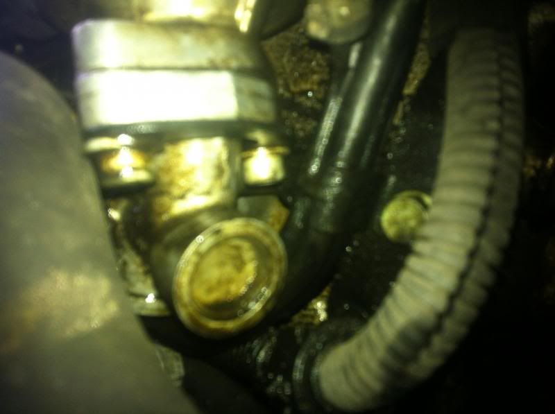

Hello,anyone no what this parts called and does please?think its leaking oil but dont no what its called to look into fixing it THANKS

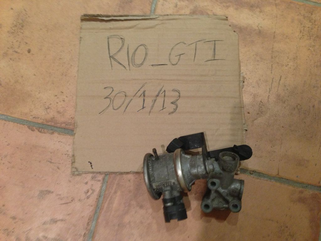

Is it this??

Yea think so mate,what is???

It's a combi valve mate, doesn't do much in all honesty get rid of it and do the SAI delete rather than take it off and put a new one on

Thanks pal,  is this part likely to be the part leaking oil? it looks like its coming from there!!

No mate it wouldn't leak oil, where it connects to the block is where coolant is, so if it was to leak anything it would be coolant, it's more than likely the rocker gasket leaking that side  :wink:
