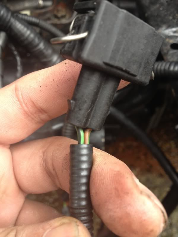

Anyone recognise this plug ?

these plugs are used on anything from reversing light switch to fog lights.....
wire colours don't immediately ring a bell with me.... which year and engine code is it?
which loom does the cable run off?

Which engine and location in bay?

1996 16v on the right hand side.

Have you got another photo that isn't so close?

does it not belong to one of the sensors on the airbox / air intake pipe?

Bet he has a induction kit

My initial thought was on the unused plug that clips onto the long plastic breather pipe to goes to the air inlet hose but thats on the left side of the engine.

and the answer to the question is: N25 = drum roll....... magnetic clutch a/c compressor
