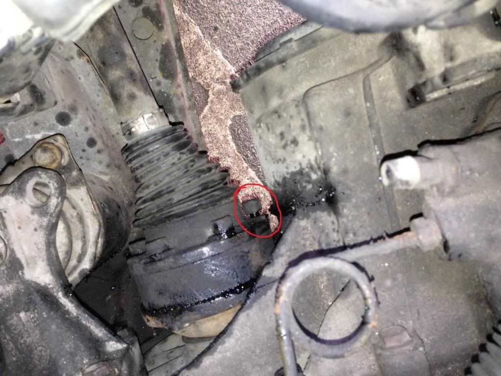

Also since having clutch changed when inside the car I can now here a tapping sound (not from the carbon canister) the sound is coming from the front bottom left corner area of the car :(
Noticed this earlier when having a look could this cause the tapping? Is this meant to be screwed all the way in? (red circle)

Nice to see the clutch fitter put the driveshaft bolts in nice and tight. I think I'd be back at that garage pulling them up on the loose bolt found and tapping noise.

Just found out this is the driveshaft -.- Two bolts are loose, the one you see in the picture and the other one is wound up but still loose! Guessing its not safe to drive like this... I rely on this car for work spoke to the mechanic taking it there for them to be tighten tomorrow will now have to get up ridiculously early and get the train to work!
