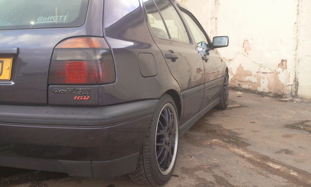

Not everyone drives to the limit of grip
Moving to 45 won't do any favours
A 205/40 tyre will give more room than a 195/45 tyre
