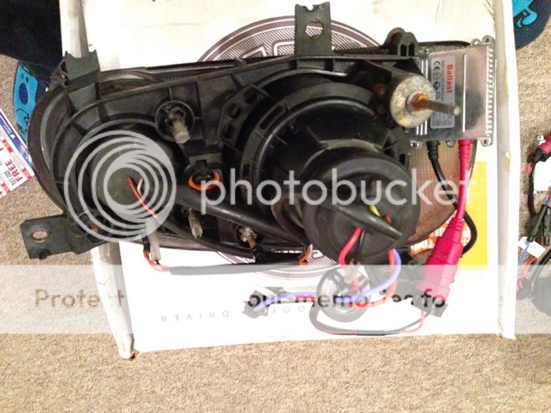

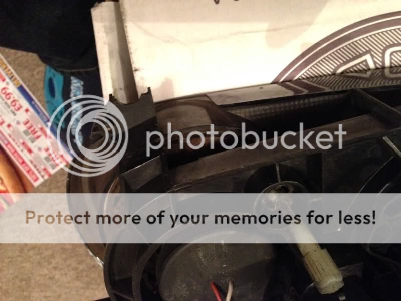

These are the screws (pics courtesy of Mr Pioneer).

I got long M6 bolts and several washers and nuts and basically made my own. Mount the bolt head up tight with a nut with washers either side onto a fixed point and then you can move the nut back and forward to adjust the beam.

Could you please get some pictures? Would very much appreciate it!

I need to replace a couple of mine too, well the white plastic piece that surrounds the screw head. I once found a German forum that suggested using some BMW parts, possibly E30? I'd have to go and find it again, also my German is next to nothing.
