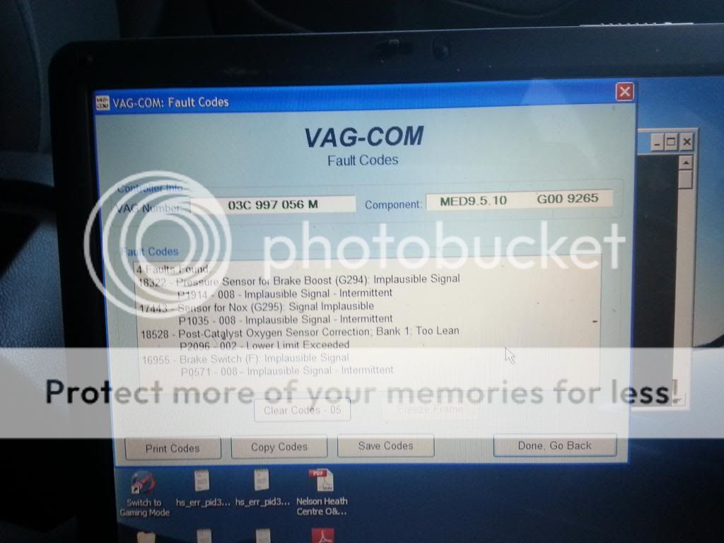

Mk4 4 for me usually, can u help me?
Car is 1.6 fsi se
04 reg
Mk5 obviously  :grin:

There's a unit at the back of the engine that is for the brake booster. My friends one had snapped wires to the plug due to a vibration caused by a broken engine mount.
Nox sensor probably needs replacement. Looking around £300 odd. Common fault
DIY?

If you have tools and ability.
The only time she goes to a garage is for mot. Done;

On the drive with hand tools.
Worth a pop?

In that case. Yep.
Nox sensors are expensive though and are that common a fault. Vw keep them in stock, but you should be able to get them elsewhere now. Like lambdapower or similar a lot cheaper.
