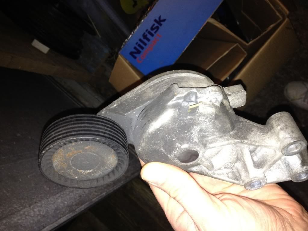

The one he's got on is one of those Febi Bilstein ones. He says it doesn't sit close enough to the engine for the belt to sit on it properly, or to read it another way, it'd need to sit in further for the belt to sit proper.
That's a photo of the original one from the car - you'll notice the wheel has grooves which lock in the belt better. The febi bilstein one is smooth & pretty much all the ones on eBay are smooth too.

The belt should not sit like you described so its either the wrong belt or tensioner.I have never herd of ECP do they sell genuine parts ? I use TPS they sell all genuine parts had problems with GSF  and I dont use Euro. I rececntly replaced all by belts and bought the cam belt kit along with the tensioner think it was around the £150 mark for the whole lot may have been a tad cheaper.Ive got that ETKA if you need any part numbers let me know.

Isnt there something that makes the tensioner sit a bit further over towards the chassis leg??  ive seen it a couple of times on a few different cars and i THINK there was some bracket or something pushing tensioner over another 3mm or something?
