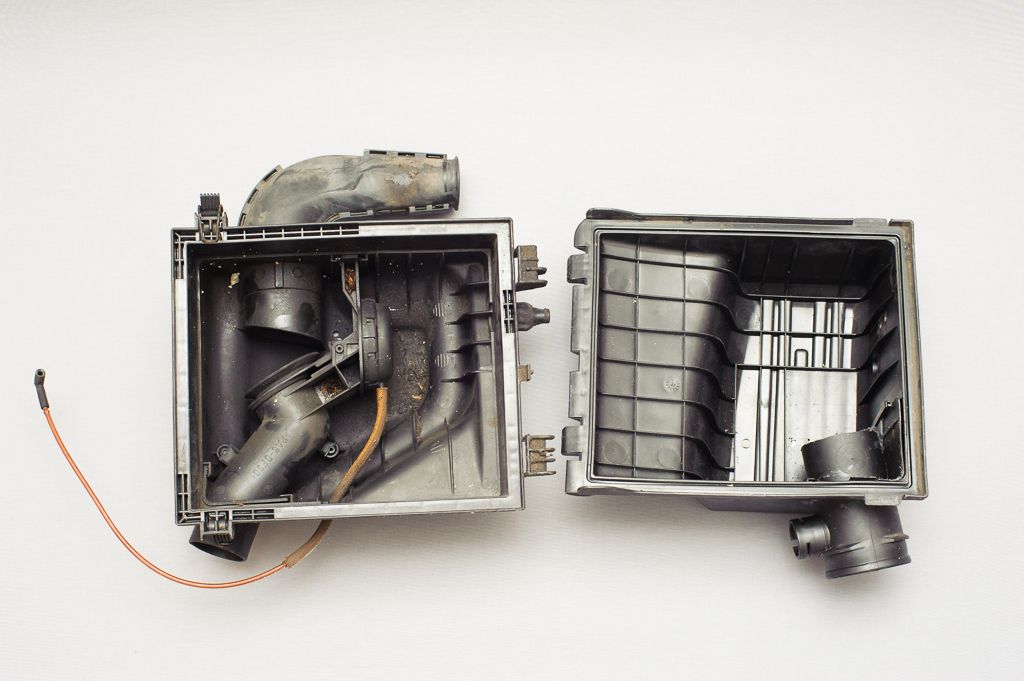

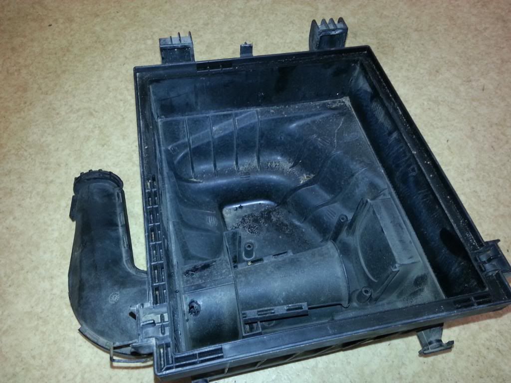

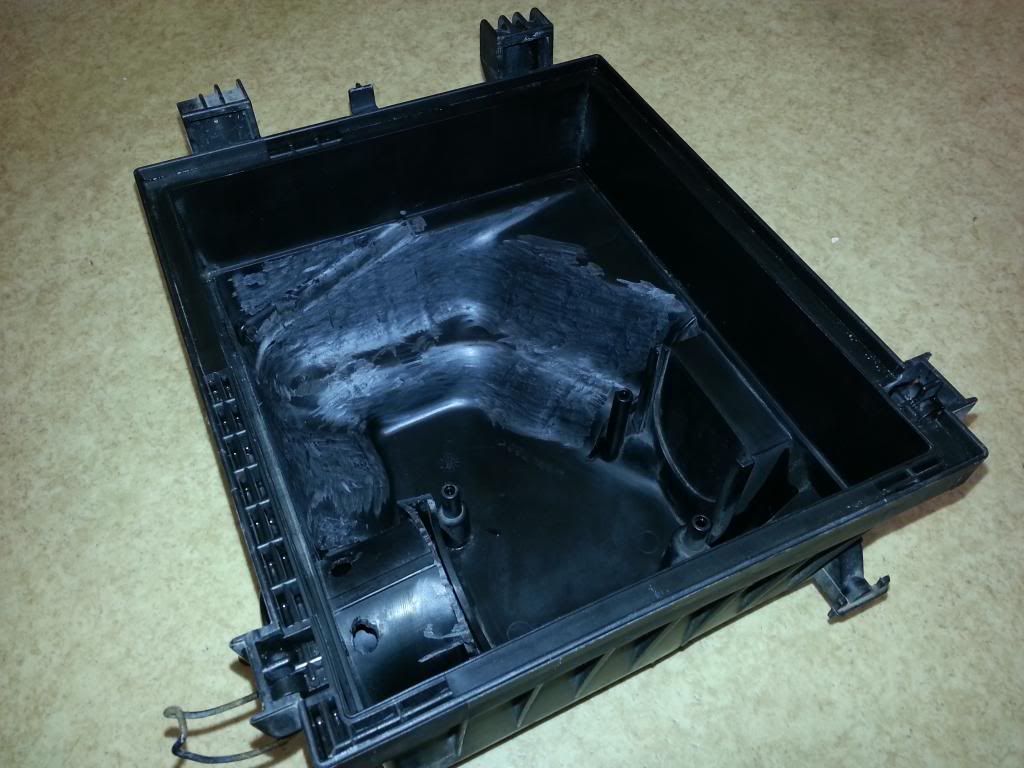

VR6's run MAF. The best thing to do is run the top half of it (or any other model you may have - for future reference for those searching the forum, so 8v and VR6 MAF and 16v for air intake temperature sensor), then use an 8v bottom half. Reason being an 8v bottom half will not have the hot air intake at the back so it saves you from not only having to remove all the obstructions the 16v and possibly VR6 bottom halves have, but also from having a big hole at the back once them obstructions are removed, meaning all the nice cold air is going out the back!
8v box (standard)
8v box (modified)
16v box (standard)

So to put it in leymans terms if I swap the bottom of the VR6 airbox for the 8v bottom I wouldn't have to to all the chopping out of the bottom of the airbox.

Exactly. Use the 8v bottom and remove the trumpet and open up that intake.
