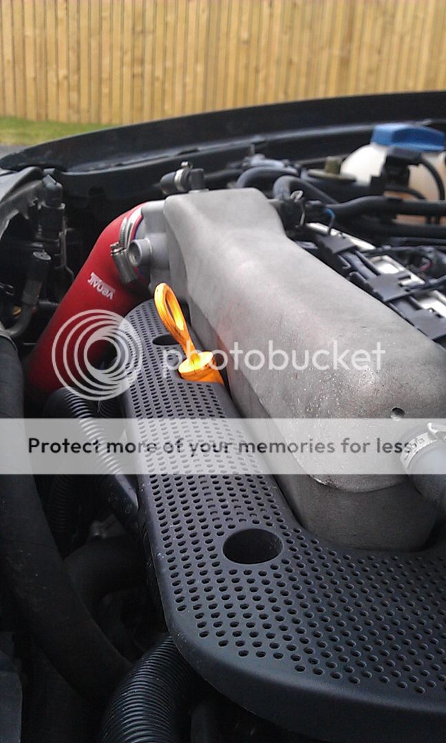

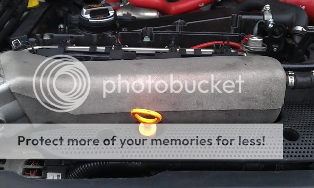

this height look about right?
everything seems to line up correctly and a worrying thing just had oil changed (broken guide) oil level sat fine, now nothing shows up on dipstick.... had 2l of oil lying around ended up putting it all in and still nothing!! -.-

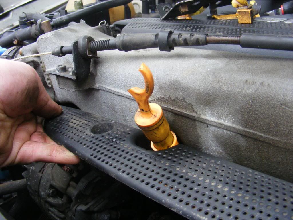

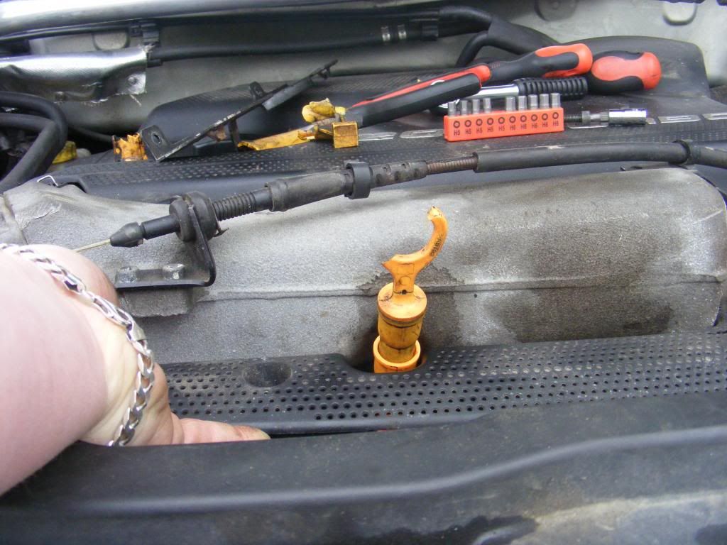

Mine sits like this:

« Reply #4 on: 22 February 2013, 16:32 »
Yes it does, I thought you'd be able to see from the pictures above.
Your dipstick guide is sitting correctly, the problem appears to be your dipstick. Something must be stopping it from going in fully. If it was me, I'd take off the lower engine cover and the plate underneath with the n249/n112 valves. Take off the dipstick guide and shine a torch into the tube underneath, my bet is there is a piece of your old guide blocking it.

« Reply #9 on: 22 February 2013, 17:14 »
yeah wasnt untill i really looked at the pic and was like hold on that looks like the tip of the new one.... lol
