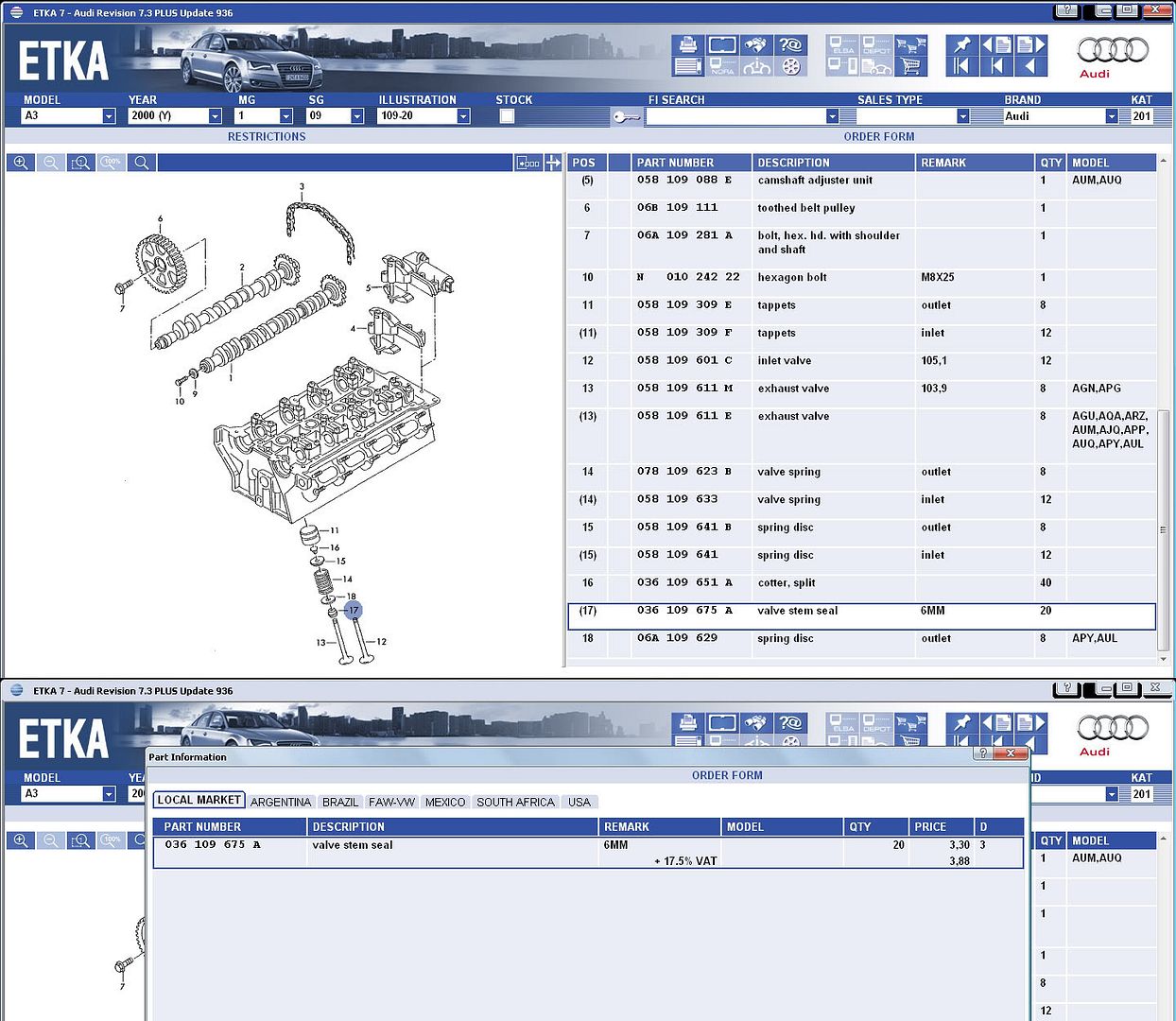

Nah,  wouldn't say that's the case.  A lot of part numbers for 1.8T start with 038 such as gaskets etc,  so saying 038 relates to a 4 pot diesel is wrong. Example:
Those will be common/carryover parts, that would have been designed for something before the 1.8T. I just googled 038 engine code and it came back with the diesel engine (as it's a diesel injector I thought it's a safe bet that that's the part origin).
If you look at those 036 prefix parts in your picture, they are stuff that you wouldn't want to design specifically or renumber. A stem seal and a split retainer. The components designed for that family of petrol engines have 058 06A and 06B as a prefix.
If you look at gaskets, as you gave in your example. Gaskets for common things, like the throttle body/intake plenum have been used elsewhere. (the throttle body is an 028 prefix). Whereas something engine specific like the intake manifold gasket has an 058 prefix.
Like I said it's not gospel and I might be wrong, but it is logical and similar to many other part numbering systems I've come across before. Can you do a search on that stem seal and see where else it was used?
