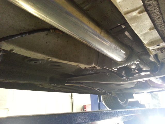

Offline davemk4
  • Posts: 694
Engine light now on gay AUMS :-(
2001 mk4 GTI 1.8t AUM. k&n induction kit with customer heat shield, 3'' TIP, Forge 007P, Stage 1 map, N249 bypass, 3'' downpipe and decat, 2.75'' Jetex cat back non res, Koni shockers and H&R springs 35mm, dimpled and grooved disks front and back

is that with the 2nd lambda spaced out?
Offline davemk4
  • Posts: 694
Yer it comes in at angle higher out. Unless they done far enough?
Offline mar_k
  • Posts: 806
My mates AUM has been running this exhaust for a few months now with no issues other than breaking the rear Lambda

Offline Chris.
  • Posts: 1,916
unscrew lambda and tie it up out the way.  Or get it mapped out properly.
