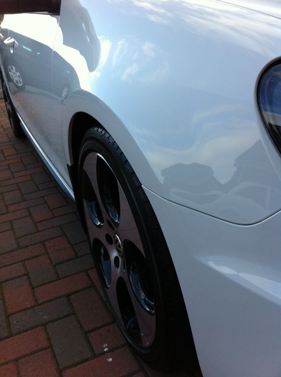

I love the ride on my car with eibach sport lines. I had pro kit springs with cup shocks on my clio 197 and that was great too.
my golf is definitely better than standard IMO and sits just right. I did measure it bu i cNt remember the exact drop but it was only around 15mm lower than standard if that.
If it were DSG or a diesel it would sit a few mm lower at the front using the springs I have. My car sits very level front to back

im sure the h&r are great too but i havent tried them on the golf. ive seen a good few mk5 and mk6 on sport lines or VWR which are basically the same and they always look right to me

« Reply #9 on: 31 January 2013, 19:36 »
Great photo... Ok, I'm convinced.  Just need GNJ to have his workshop finished..
