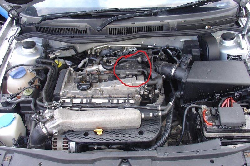

Hi as name suggests im looking for a part and i dont know what its called.
Its the plastic case that side above the furthest left coilpack and it screws down to a metal braket?
I broke it pulling it off when my coilpack melted and i was on a rescue mission to save my car ha
Any help would be very greatful thanks!

oops if yout looking at engine bay from the front its on the right (side with air filter) sorry!
no pics at the moment!

I have a feeling I ready somewhere you can bypass these pretty easy?

I would bybass it if theres a thread on it but whats it called ha also i was going to just replace as standard if i cant bypass it.
Anyone know what it is?

Vacuum reservoir for the dump valve
How to remove along with N249 bypass:
http://uk-mkivs.net/forums/p/265883/1744207.aspx

Deffo bypass it  :wink:

That Write-up is on a AUM would it be the same on a AUQ??
before i start taking things apart to find its all different ha

Yep I used that guide for my auq
