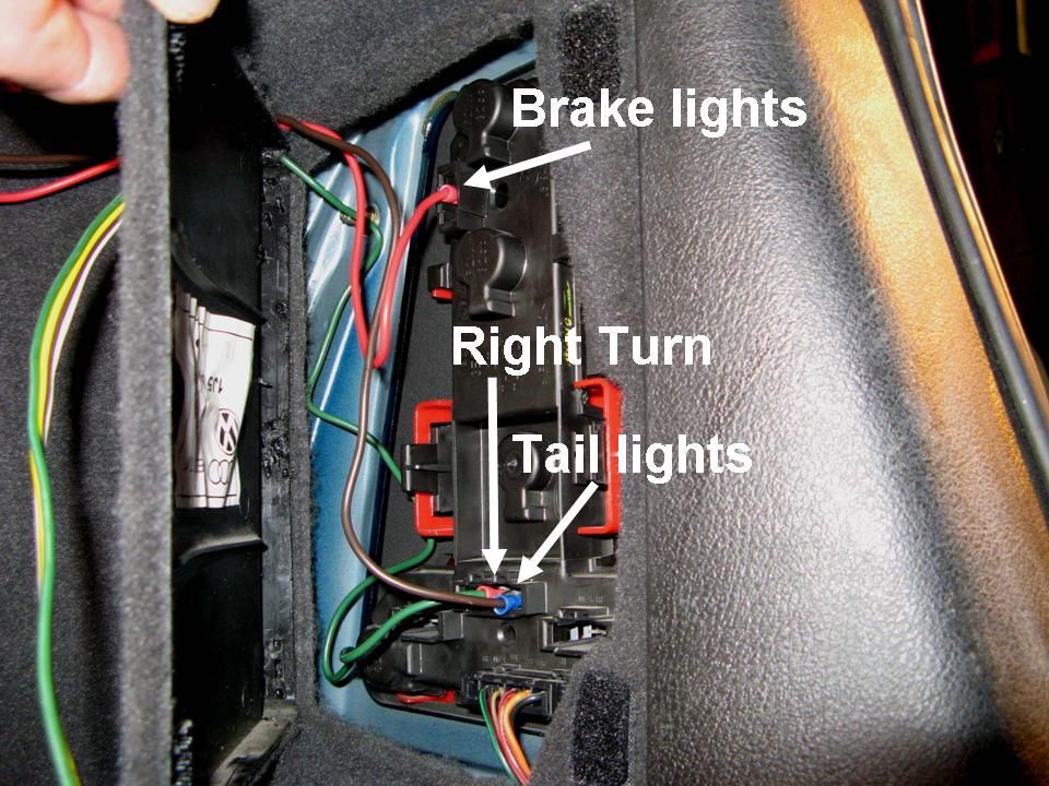

had a look, I'll be soldering the resistor to these pins

It works! I ended up passing the wires through the socket and soldered the wires to the tracks of the other side, the pins are galvanized so I couldn't get the solder to take, as were the tracks on the other side, I just sanded a small area down to remove the zinc, soldered the wires on and secured the resistor with some tiny cable ties. Cant really get a pic up as they're already fitted to my car.

There are spare terminals on the back of the bulb holder, if you trace the tracks you can add a resistor to the terminals rather than splicing into the wires. I've done this and it works a treat
Are the spare terminals your talking about the ones marked  by the arrows on this pic?  Not of my car by the way LOL
