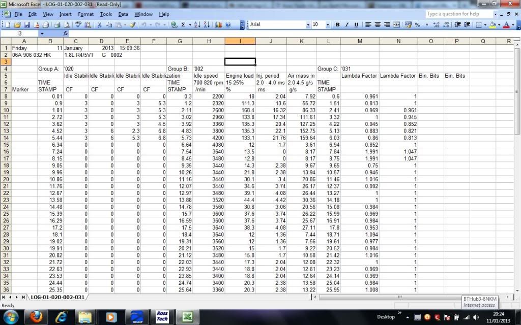

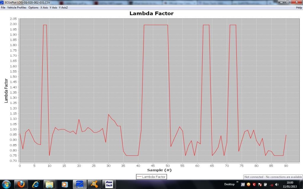

Could anyone make any sense of this vag com log

A long of coasting, idle driving and occasional 5 second sprint?

Lol well I did a 2.5ish to redline 3rd gear pull but quite hard as I was by myself  :whistle:
Does it look like im running way to lean ???

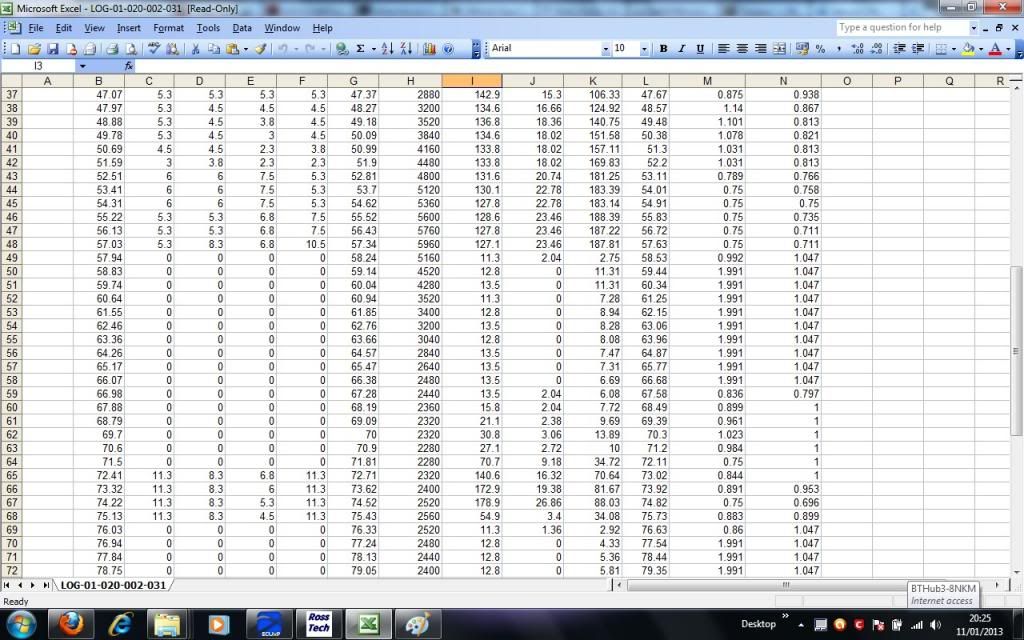

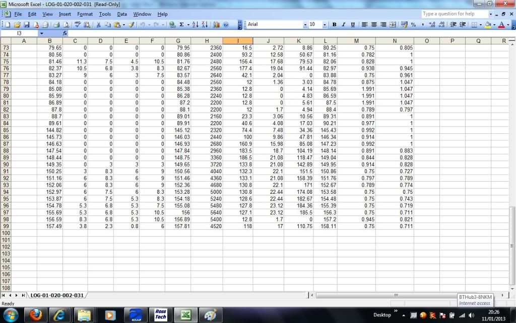

Ideally need to see the figures from the redline part of the run. When theres full throttle.

as you can probably tell total noob at this I logged blocks 20 - 02 -31. I'm just installing Excel and i try transferring the .csv on there. I don't even know what im doing on Ecuxplot

can't really make sense of that graph. Log 3, 31 and 115 to get an idea of how its fuelling, also make a note of the fuel trims (32). You can email me the csv if you get stuck

still can't really tell, you need to see what the fuel is at certain load/boost and compare against maf values.. although it seems to be requesting 0.75 lambda in places which means the ecu is dumping fuel to cool things down. It's not lean though!
you dont need to log 32 just see what the values are after the fuel trims have settled, you'll need to drive it around for a while after resetting fault codes because that also resets fuel trims. 118 might be handy too that'll give you inlet temps as well as n75 dc so you can see how hard the turbo is being worked.
