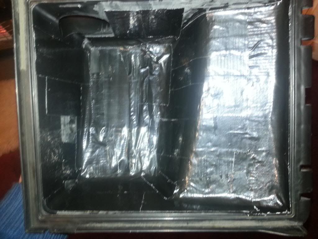

Might do mine then line it with silver tape  :grin:
Not silver tape, but I did as Ess_three about lining it with heat reflective gold foil, to give it an extra layer of heat protection, but he said the plastic is a good enough insulator so there's no need for the foil. Reason I got rid of fins is to create smoother airflow upwards into the filter + more room inside (only by a bit, but the amount of plastic I removed was surprising!)  :smiley:
I use silver tape for work so always have it about, gold sounds expensive lol
I thought that using the silver tape will really smooth for better airflow that's all.

So this is the final setup. A bit different from the sealed airbox I had planned. I think this will be a better setup overall. I did what tweed had also done to his, duct tape on the inside to smooth it off even more!
We'll see what improvements there are :smiley:
