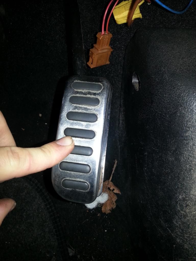

anyone running a set?
bought some the other day and all the gen part numbers etc
from everything iv read on the net they should near enough be a straight fit (maybe bend the gas pedal a bit)
However my accelerater pedal seems alot bigger than the tt cover so dont see how it fits. il get a photo shortly of what i mean but seems weird!

From what i understand you need two clutch pedal covers which go on with some rubber removed and the accelerater pedal cover just needs flattening.

well yea i thought it just needed flattening but mine seems no where near wide enough either! parts numbers are all fine.
theres a gap of a few mm each side

I read somewhere you need the LHD TT accelerator pedal which may explain why it's not fitting

From reading that it would seem you require
LHD accelerator
RHD clutch
RHD brake

Cant you just narrow your acc pedal a few mm either side?

Or even 2 rhd clutch covers so you dont have to trim the rubber from the rear.
