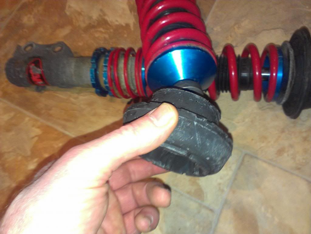

need some advice on order of fit with these jamex coilovers,these where fitted to a mk2 hence the big mount on shock in picture,what i need to know is does the upper mount in my hand go straight onto the top or does it need a plate like the one in mk2 setup?
