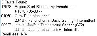

Now I have had this repetitive fault code from the Immobilizer nearly each time I scan, but now two more have popped up.
I am confused as the one is about Glow Plug Monitoring, yet my car isn't even diesel..
And the other, I have no idea what it is referring to either, help would be appreciated.

see the ross tech wiki:
17978 -> http://wiki.ross-tech.com/wiki/index.php/17978/P1570/005488
01050 -> not sure
00527 -> suggest a faulty sensor or wiring issue (probably at the sensor connector end)
