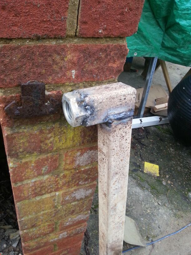

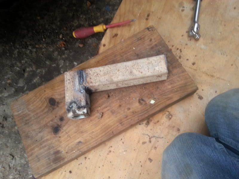

Got a Halfords Pro one today as repaired my old one and it re-shattered during a 180nm torque session. I then took the old one apart and put an arc welder to it which kept tripping the crappy 15amp breaker wired up to two garages and a BIG pool pump. :huh: It now resides as another 1/2" breaker bar.
I had a Honda Civic to do a cambelt on. I made a tool up for it rather then ordering and waiting for one.
Excuse the building works going on in the background.
Cut to size:
This is the bugger:
Works PERFECTLY:
Used the remaining 50mm box section on that tiny 1/2"  angled thing whatever it's original use was for and undid straight away. Heard the snap and thought one of the extensions had gone but was fine.
Need some more 3/4" and 1" extensions and sockets.
The eagle eyed may notice the nut is slightly facing downwards. Allows it to sit flush on the chassis legs. Bit of a guess bit it worked. Cleaned the nasty welds up and gonna paint it and keep it.
