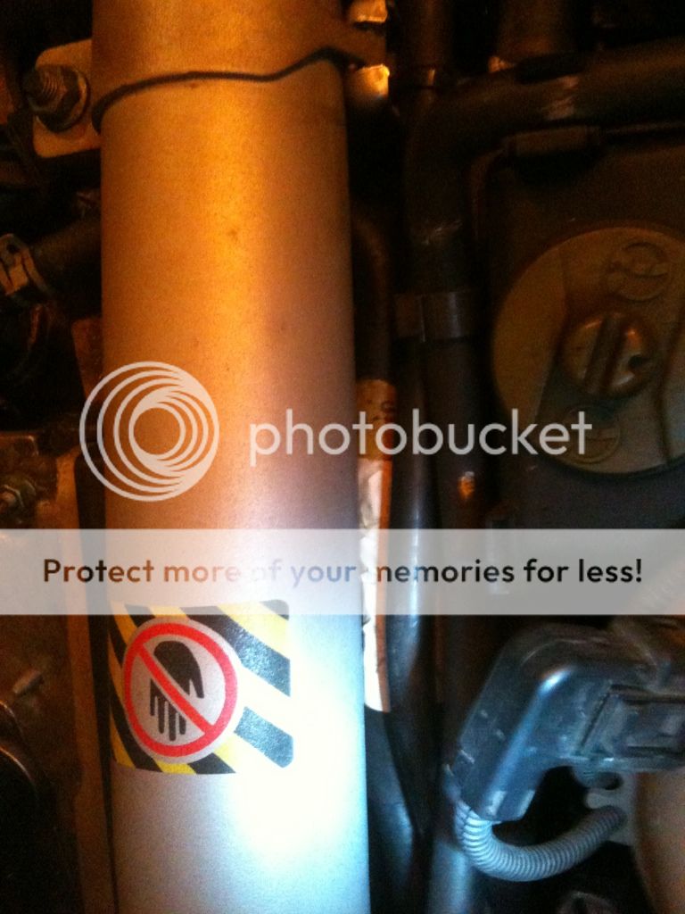

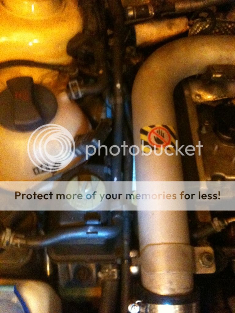

does anyone have an S3/LCR fuel rail picture, looked all over google and cant get anything, I'm just looking for the difference to the golf one, I believe where the fuel lines join it are different but wanted to see where so I can visualise the difference

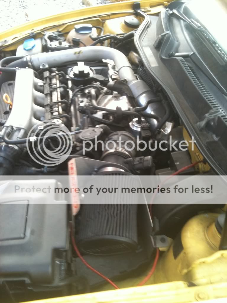

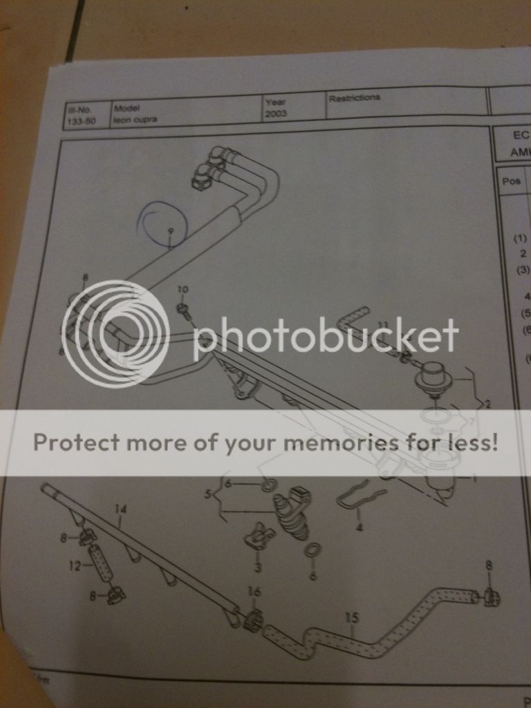

I have on attached to my car  :smiley: here's a few random Photos I've got on my phone. If you want I'll take a few more tonight.

Looking at though you'll need a photo from the drivers side?

Yeah I need one from the drivers side to see where the pipes route around the K04 charge pipe, I think they are just bent different and are slightly longer (from what I have read anyway)
but can never get any pics that show it in situ with the K04  :wink:

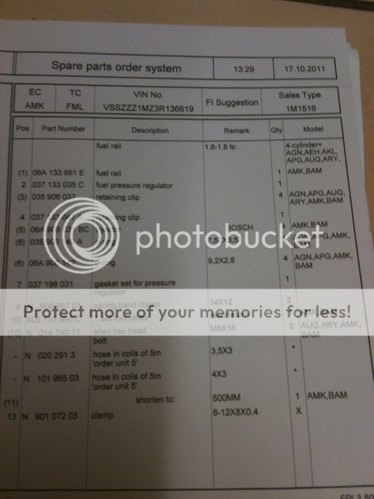

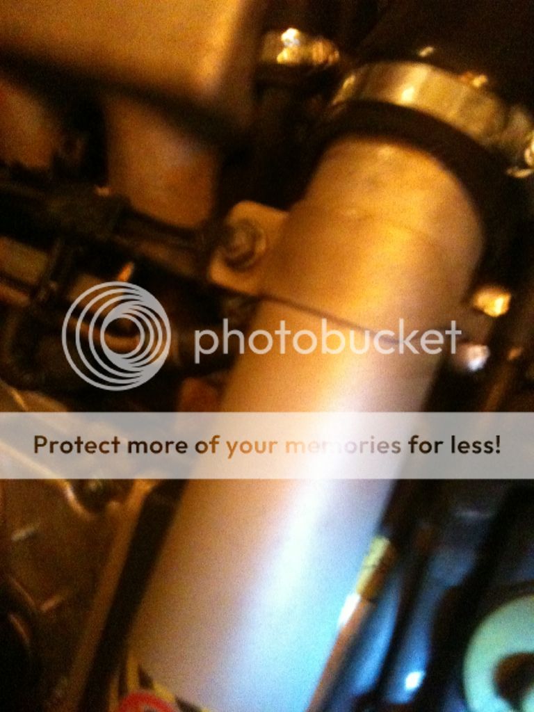

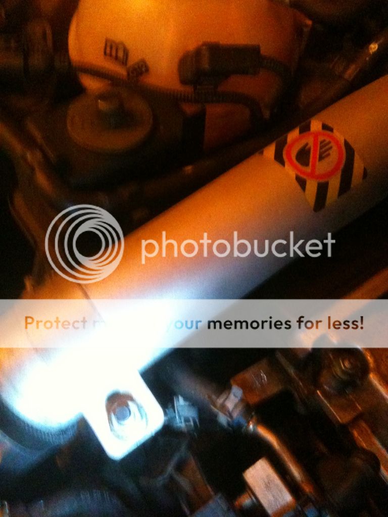

« Reply #5 on: 10 December 2012, 20:03 »
It's dark out side so I had to improvise :grin:
Last year I had the petrol lines replaced by the charge pipe. Due to the heat they perish after a while. Jabba sport replaced them while it was in for a service and they gave me details of what was replaced.
Hope that helps. If you want any more photos just let me know.  :wink:
