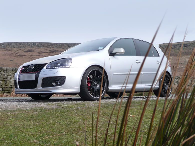

I had black edition BBS CH's with the stainless rim protector........not cheap! 8" x 19" ET48 with 235/35/19 tyres.

f**king beautiful those rims! I might have to take a look into some of these for the summer....  :smiley:

"Can you link me in some decent 19's Hurdy? I'm thinking I might fancy a change sometime next year and don't really want to lower the car, so the bigger wheels would look better, by filling the arch a bit more."
unfortunatly it doesnt work like that mate it ll still need lowering even if you put 19" s on , all it does is make the car look too high if you running stock suspension .
