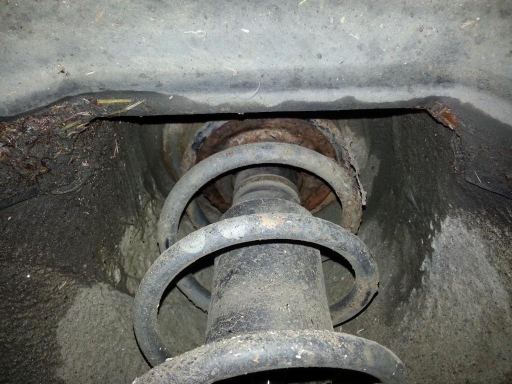

I would though like somebody's input on this picture, I hope you are able to see what I mean:
What has broken off looks like --> C <-- so that much is missing from the top of the spring. If you can tell in the pic, the spring has gone over the top plate and is now resting against the frame. What is the best way to proceed here?
If I put clamps on first it will try and drag down the top plate, which of course won't budge and I don't what it to go pop while I'm under there.
Do you think as the spring is now higher that there might be no tension left and I could just safely remove the top nut and lower bolts? Any way I can know for sure there is no tension on it?
Cheers fellas
Edit: A dull moment of mine, my girlfriend just suggested to put the clamps on, tighten it slightly and then loosen it all...if it is still under tension then it can't go up anyway lol...guess that would be the best way? :)

Offline Diamond Hell
  • Posts: 7,992
  • Opinions я Us
Re: Front passenger spring snapped, considering options
« Reply #7 on: 28 November 2012, 19:04 »
I don't think you're going to have any problems with spring tension there.
Remove the top plate on the top of the turret, in the engine bay, then jack up the car.  If the spring is now against the top of the inside of the turret, as you jack it up it will release gently.
If it's still trapped under the plate then remove the strut and check to see if there's any tension on the spring.  If there is apply the spring compressors on the deck and buzz the top mount off.
Incidentally, the benefits of going to early Golf3 top mounts and spring plates is that you get away from that moronic slotted nut thing and the top mounts are dead simple and more durable.
For 5mm it's worth the effort.
