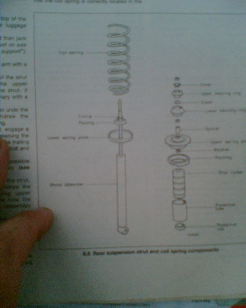

what part do they sit in?? I recon i may be missing a few bits. Some chump has fitted the suspension prior to me.. think i am going to be buying a new rear strut.. Mine are yellow.. any idea who makes them?? umm

« Reply #16 on: 18 July 2005, 11:11 »
Hey..
thanks for all the advice guys.. I'm pretty sure its just the circlip, id buy new struts but i quite fancy some coilovers so gonna try and get a circlip until i can afford the coilovers..
Ok Haynes manual has a picture of the suspension strut.. have a look below.. its not a great image but you get the idear.
Worse bit was.. ive spent the whole day cleaning her. Wheels have just come back fully refurbished so had clean and wax them before they went on. gave the whole car a good clean, she looks sweet.. then i took her up the road and could hear the parcel sheft moving, thinking what the he11 is that.. THen realised it was the suspension trying to get through.. LOL... Feking thing..
Gonna post some good pictures of her soon..  :wink:
In the picture the washer I'm talking about is the one just above the the bumpstop but below the metal top spring retainer ( If that makes sense ) :huh:
I can't quite make out the words on the picture/diagram to know what they list it as :undecided:

A nice clear ETKA diagram for you :)

21 = clip     9=washer :wink:

Sweet... Cheers Mate.. ok i need both parts.. where can i order them from.. umm
