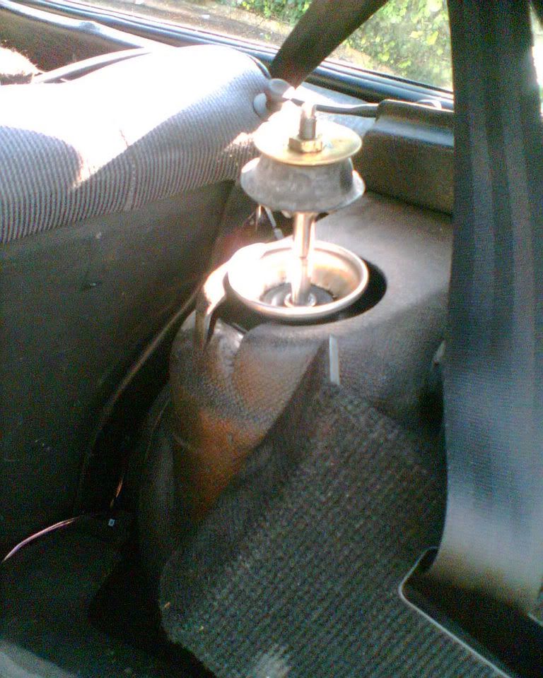

OK take a look at the picture below. car is sitting on the flat and suspensive is doing this.. i can move the rod up and down but didnt like to push it too far.. Any ideas???     :undecided:

Looks like strut internals are f....d. causing the strut to protrude as much. You were hopefully looking for a more informed reply and I am sure it wil come in good time. You will however need to replace the strut, costs very little at GSF or Eurocarparts, as I am sure you already know. Sorry if I am stating the obvious.

just had it all apart.. its a small circlip which stops the damper shaft moving up to far.. Its snapped. guessin i just need a new clip.
Knobby
Correct, there is a measly circlip that sits in a grove on all shocks at the rear, this stops the spring from going all the way down the damper and letting the body drop. Unfortunately its not a simple fix of getting a new circlip. Whilst that one has been missing the other strut will be taking the majority of the weight of the rear of the car when going over bumps.
Best solution is to replace both of them with boge gas shocks from GSF, only £40 each and will give you peace of mind. Not quite as scary as you first thought though.  :smiley: :smiley:

I am not entirely sure that the diagnosis about the circlip is the full story. I had the same problem with mine and what had happened was that a large metal washer that sits above the lower rubber bush had stress fractured and broken apart thus allowing the insert to pop through into the boot exactly as yours did. I do not think that my struts had circlips. Anyway, I replaced the large washers on both sides of the car but I feel that the rear suspension is very harsh ad have never been really happy with it as I feel every bump on uneven roads.

From looking at it, and what he has said it is the full story, i had mine collapse on me because the circlip broke and i was doing 60 down a dual carriage way. Not a great experience and at the end of the day everything points towards the clip more than anything else as the top looks solid.

thanks for all the advice guys.. I'm pretty sure its just the circlip, id buy new struts but i quite fancy some coilovers so gonna try and get a circlip until i can afford the coilovers..
