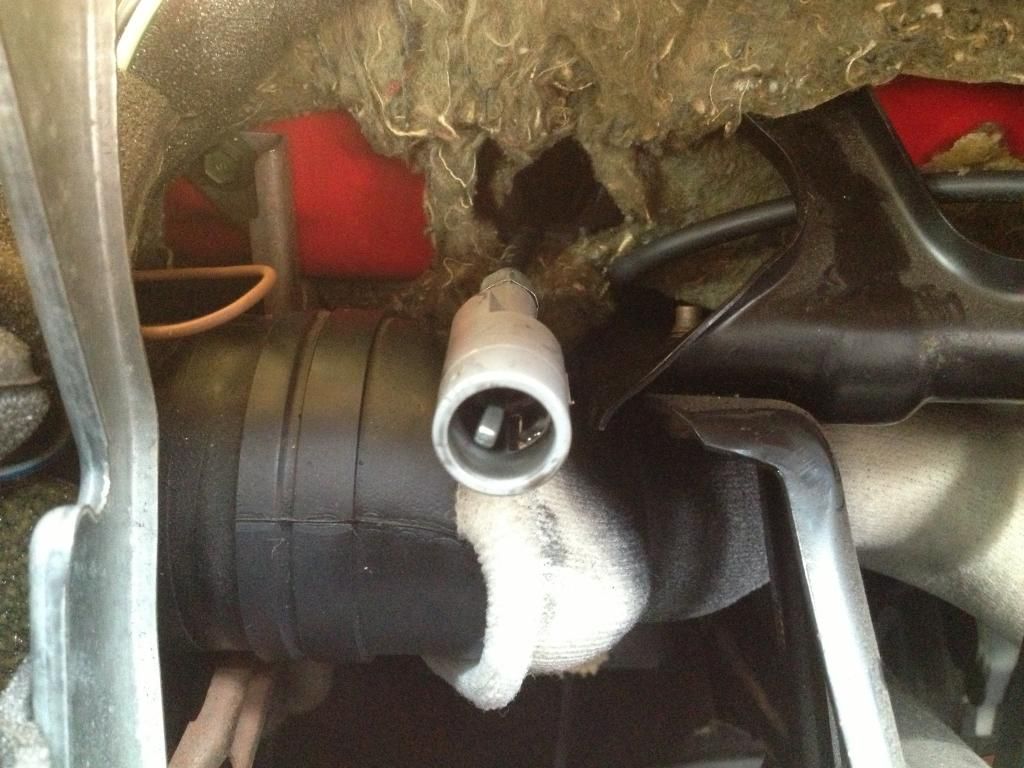

« Reply #6 on: 15 November 2012, 17:48 »
The puddle
CComing out the cable
Back of the clocks

« Reply #7 on: 19 November 2012, 10:33 »
Well, now I see your pics, it can't be brake fluid!
I'm not aware of a beather on the mk2 box, it has plenty of space in there for expansion, you sure its not been overfilled?
