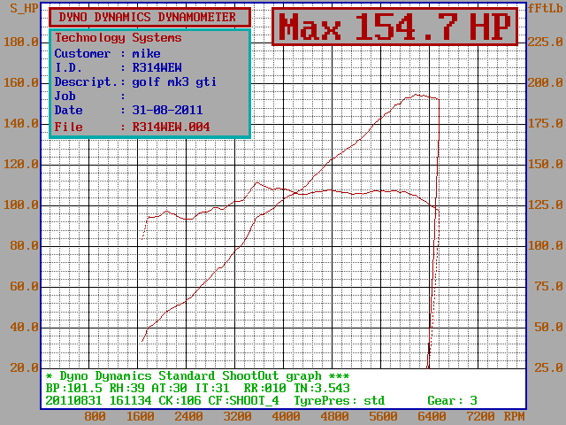

Went along to badger 5's today for a rolling road day which was very busy and a good place to meet people mostly audi drivers though to many s3's for my liking  :sad: here's my result which i'm really happy with bit of an improvement from last year.
Last years chart
todays chart and results

Have you done anything or is this just dyno to dyno variation?

a good service and running it on v power for the last 6 months is all that is different and fixed a vacum leak that's it really was a coldish afternoon as well so that might help a bit quite happy as this dyno is known to be quite accurate  :smiley:

If its a standard ABF peak torque seems to be a bit high in the rev range on the second chart giving higher readings. Max torque at 6200rpm on a standard ABF isnt going to happen. Component protection comes into play and ecu runs a very rich mixture preventing higher outputs
1st dyno chart seems more accurate with peaks in the correct places

all its had done to it is a sports cat with cat back system and enclosed induction with cold air feed and a supposedly chipped ecu but I have no prof weather or not it has  :undecided:

Then i'd say it probably not an increase
