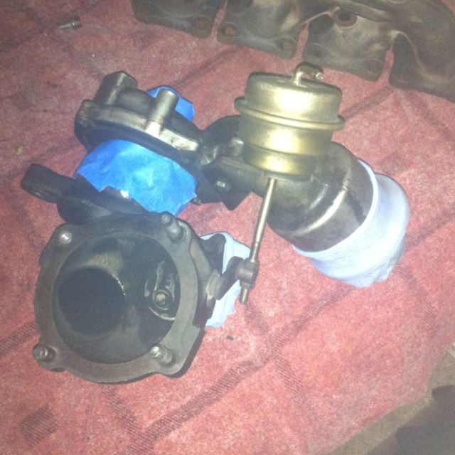

post a pic so we can see how many blades it has on the inducer.... or just tell us

got the part number its a k03 thanks

12 fins then

That pic is a K03s found on AUQ's only.

looks like a K03s off an AUQ as Jamie says; the inlet has a silencer

Yepp silencer and 8 blades me thinks

it just when from £49 on ebay a thought it was a k03 or a would have bought it says on the add its a k03

Yepp ko3 - 052 I think. A ko3s isnt marked as "ko3s on the turbocharger mate. Things to look out for is either 8blades NOT 12. And silencer as above. Otherwise part numbers.
