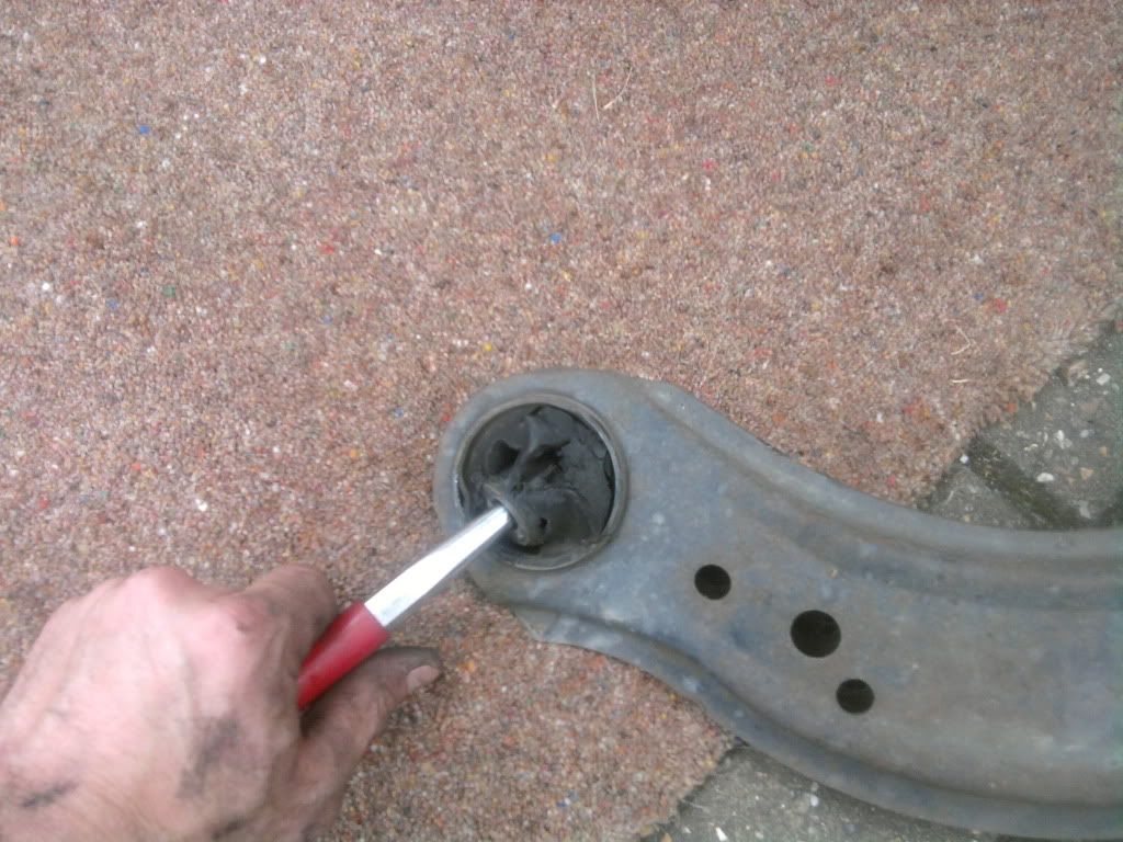

Check the lower arm bushes, Mine were completely shot, The wish bone was knocking against the subframe.
Also loud knocks heard when braking very hard. I could hold the wheel at 9 o'clock and 3 o'clock and move it back and fourth, The bush was more or less turning inside out.

what mark said ... mine was lower arm bushes but i just had new lower arms cuz they looked like rust bags anyway :-/
