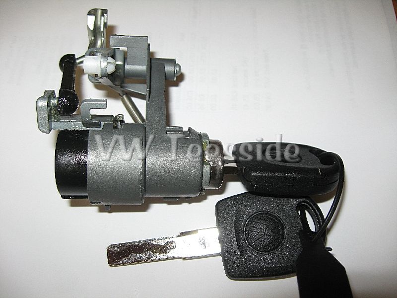

a freind texted me saying his car unlock with remote the doors but wont open the boot. he has to use the key to unlock. what possible could be the problem
barrym381
Forum addict
Posts: 5,934
Re: golf boot lock
20 October 2012, 23:57 »
a little sh!tty plastic clip that comes off
opel
Posts: 978
Re: golf boot lock
21 October 2012, 00:01 »
well he said he can here it trying to unlock but doent
barrym381
Forum addict
Posts: 5,934
Re: golf boot lock
21 October 2012, 00:09 »
Quote from: opel on 21 October 2012, 00:01
mine was the little black clip that came off
Dalo Harkin
Posts: 2,070
Re: golf boot lock
21 October 2012, 08:50 »
there isnt much else it can be other than the clip especially if the motor is moving / making a noise
