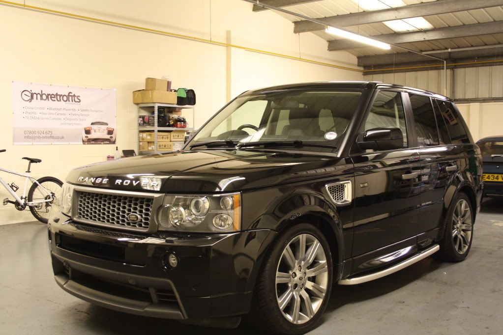

Car before I start

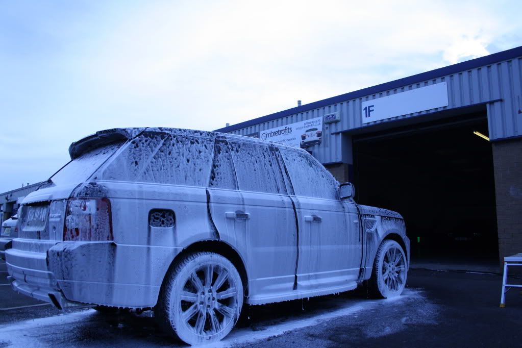

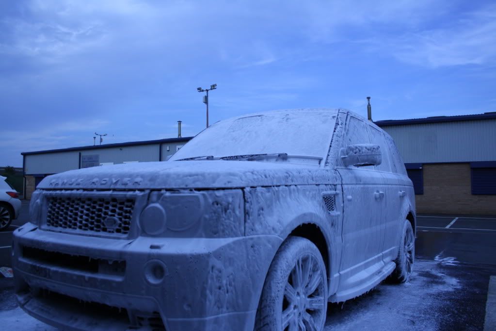

The car was then given its first coat of snow foam whilst this was dwelling I went round the car using APC in a foaming head bottle cleaning the fuel filler area and various gaps and grills. The snowfoam was then blasted off with the pressure washer, and then the car was given another coat of the same mix snowfoam and the car was washed using the 2 bucket method with grit guards in both buckets and a Carpro lambswool wash mitt.

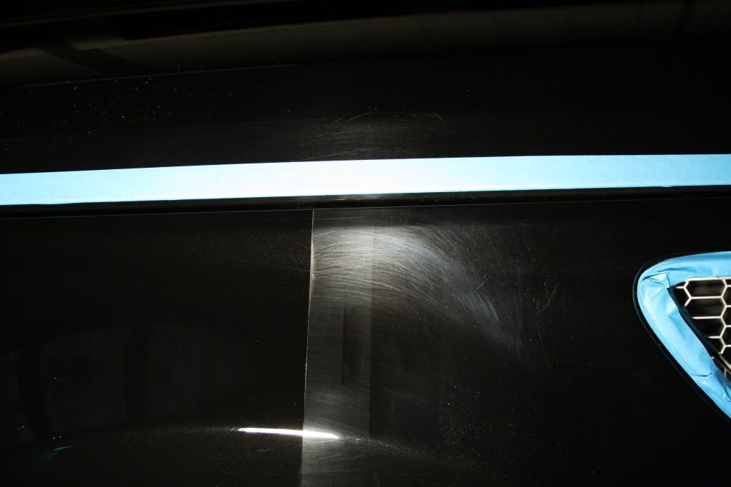

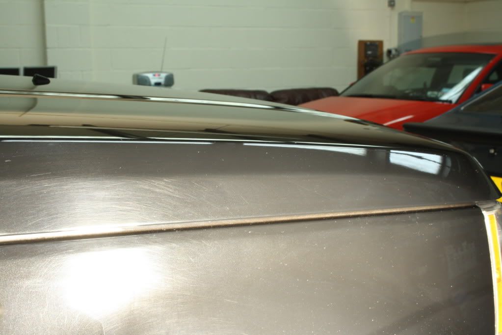

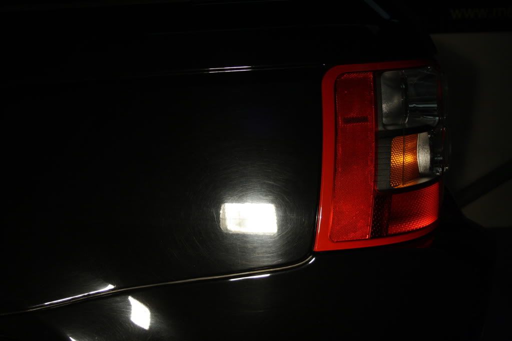

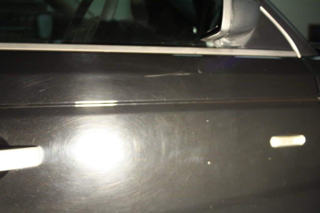

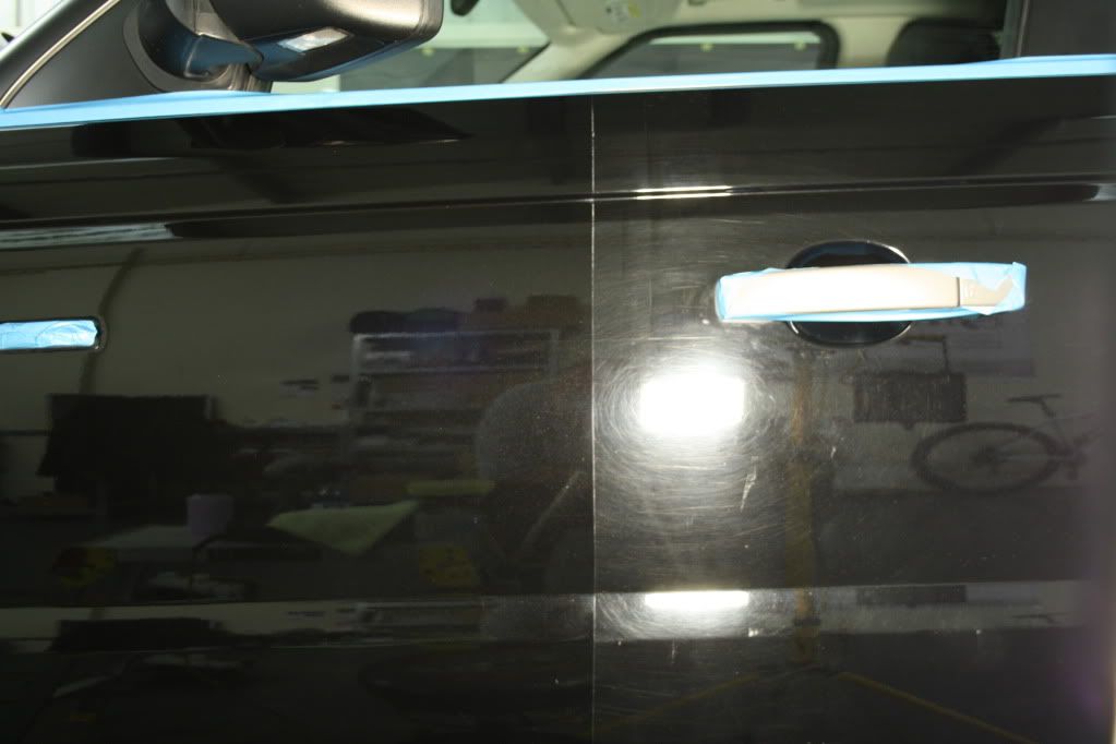

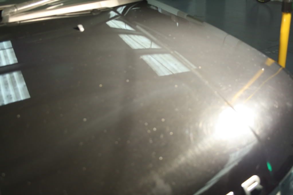

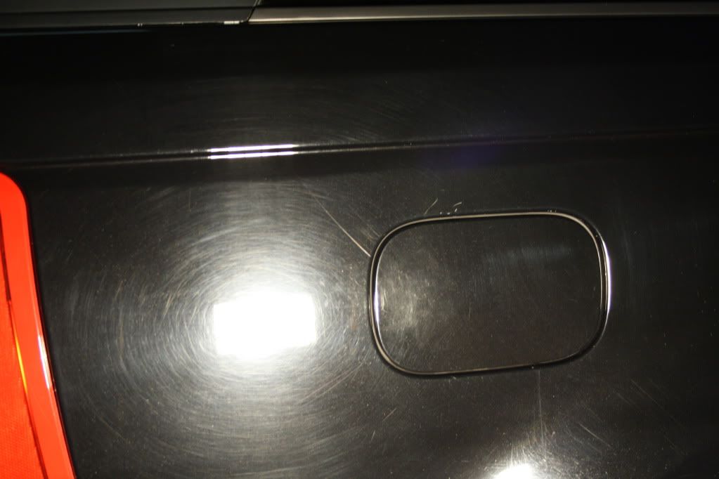

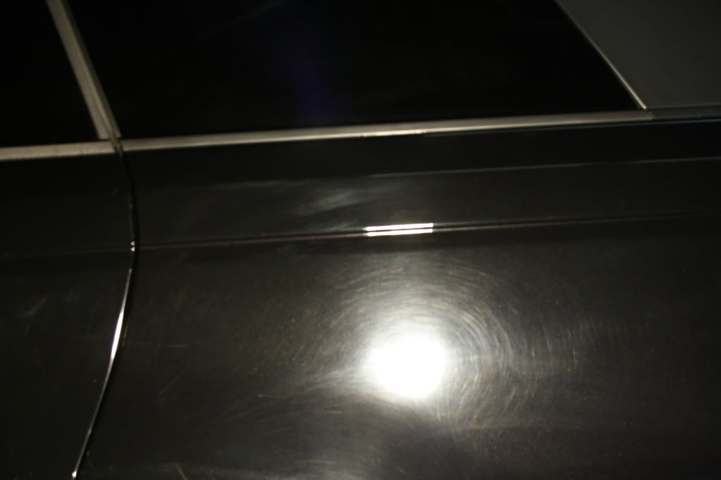

Some shots of the car before showing swirls

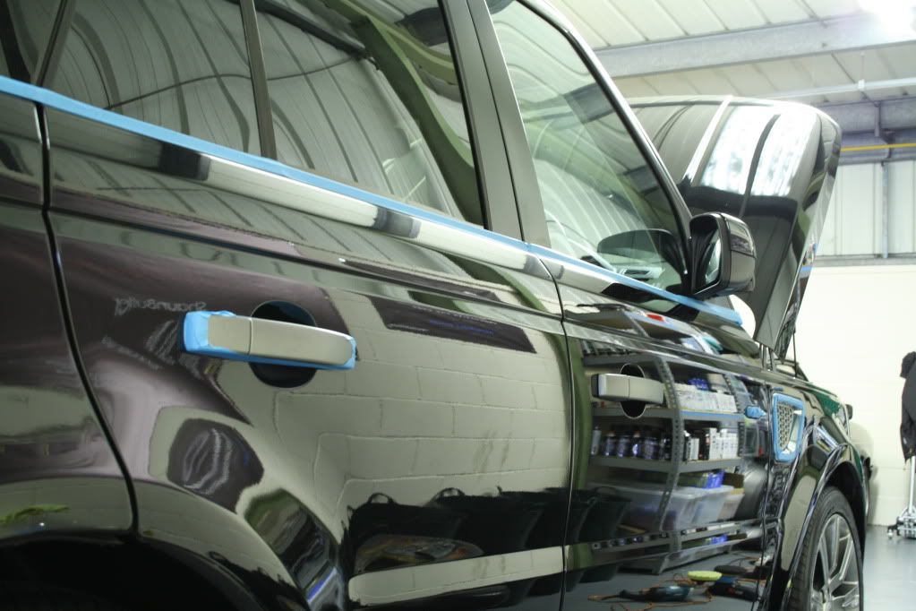

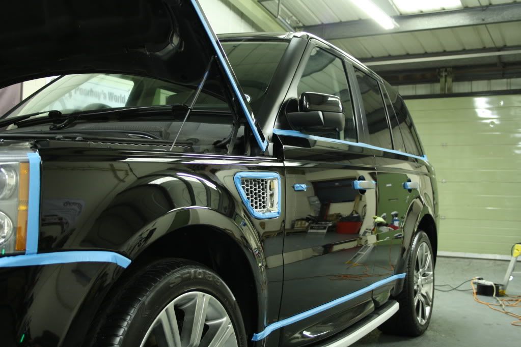

I then taped the car up and went round with various yellow 3m pads and Scholl S17+ polish, each panel was given a wipe down with Carpro eraser after polishing to check finish and remove any polishing oils.
I then went round the car a using the DA and Britemax blackmax on a black 3m pad which was buffed using Uber buffing towels.

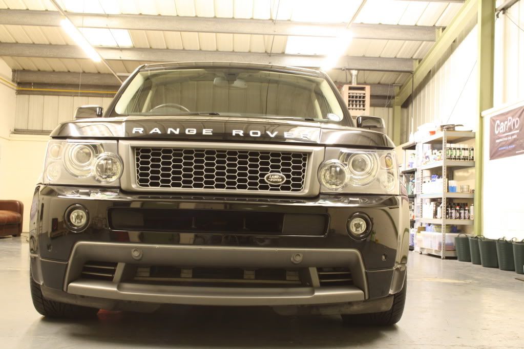

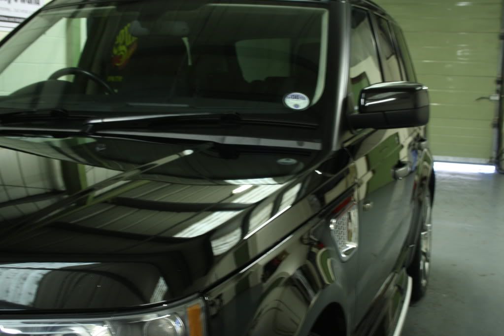

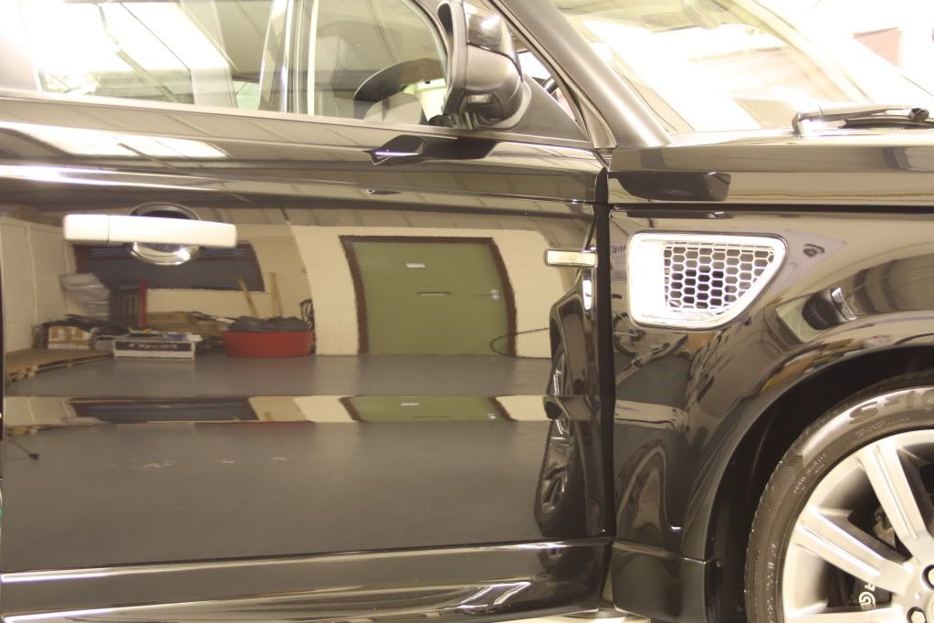

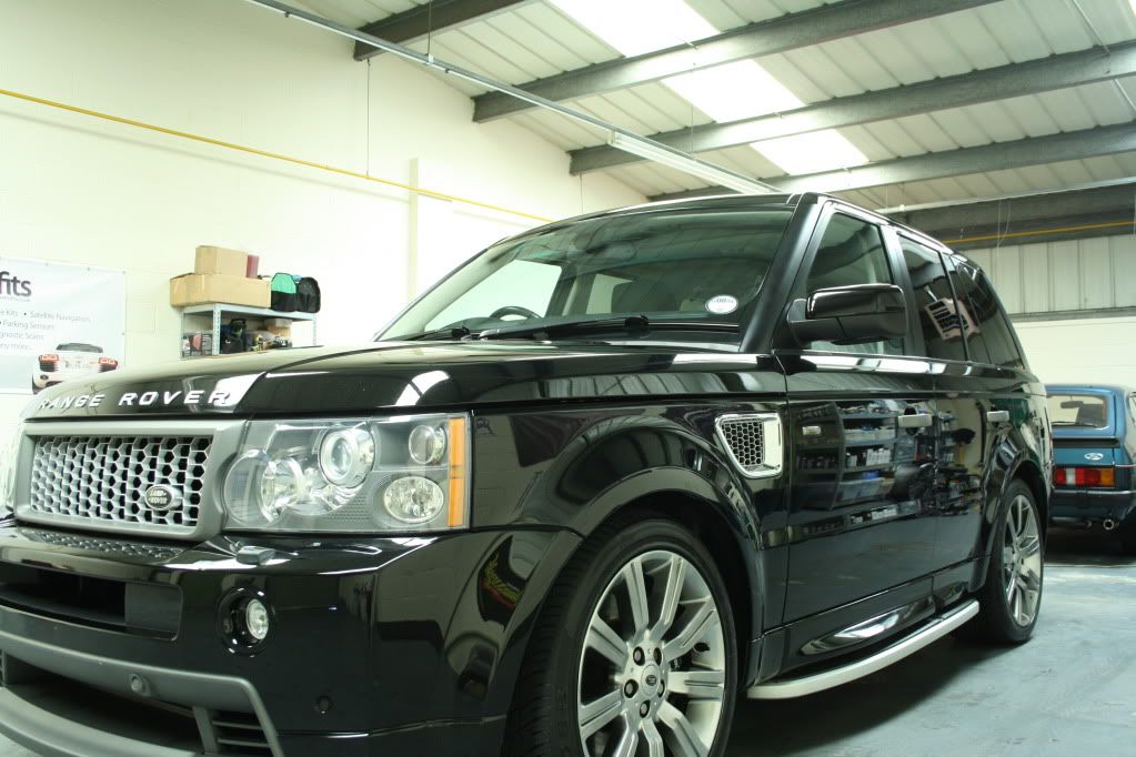

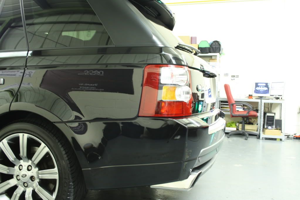

 Finished shots

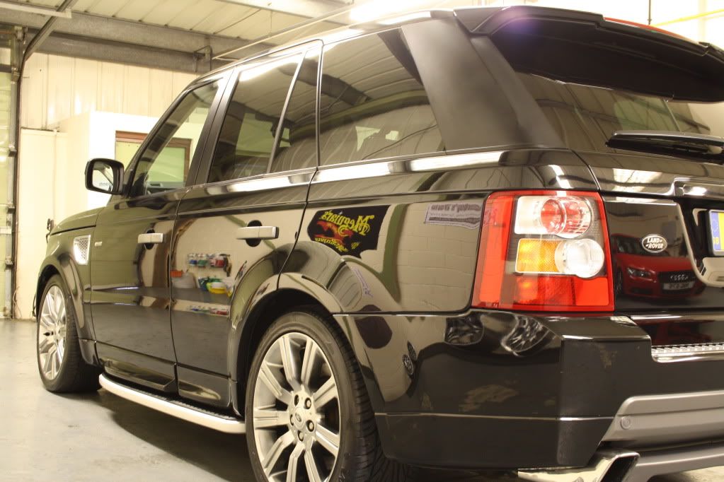

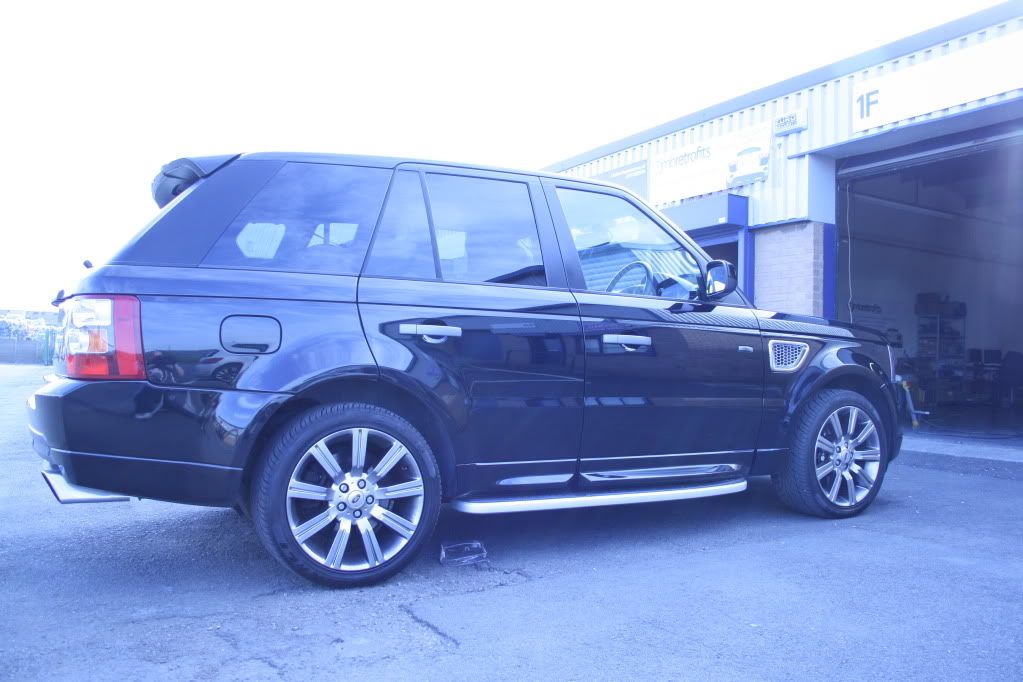

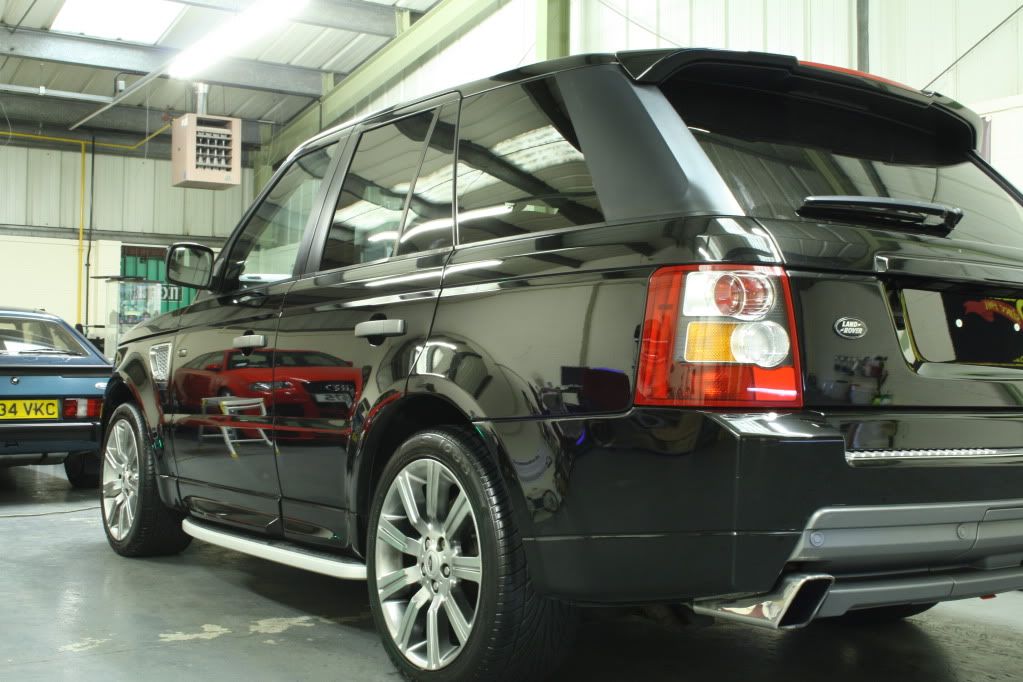

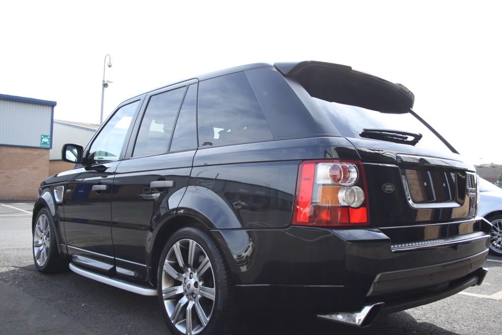

Sun was shinning so some outside shots
Final shots before refitting plates ready for customer to collect

Woowww. Some serious swirls before hand!
Premium work for a premium car. Keep it up mate! :smiley:
