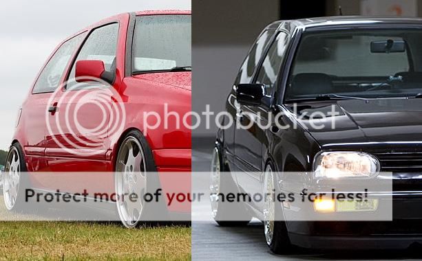

How do you get your rears to stick out soo much ? my alloy size is all same front and back, Calibre Vintage- they are on 215/40/17 tyres...

Wide wheels and spacers???

Do research before buying new wheels or ask a question on here first.
Here ill start. Buy 9" wide rear wheels with et20 then buy a 5mm spacer with you want a little more.

problem is.... ilove my calibre vintage's too much .... i want them pullin out...

Tell me the wheel specs and ill tell you want spacer to get.
Also you need to roll your arch lips and flare them a bit to look like them cars

my wheels are 8.0 all way round 17" ... and to get arches like that, hw much would it cost ?

Need to know the et!

i think they are ET35 ..... not sure wheels are at home.... n im not home..

Get 15mm or 20mm hubcentric spacer.
Also tyres are a little wide. I run 195/45/16 on 9" rears and 195/40/16 on 8" fronts

i meant 205/40/17 and would i need to get arches rolled or flared ? confused
