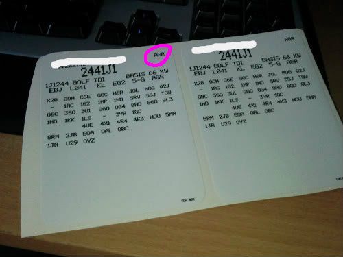

there should be a sticker in spare wheel its on that

should look like this
there's a other places but cant remember off top of my head

open your boot, lift the carpet on the left hand side and you should see a white stick, OR... take your engine cover off and look on the bracket, and it will be stamped on there
