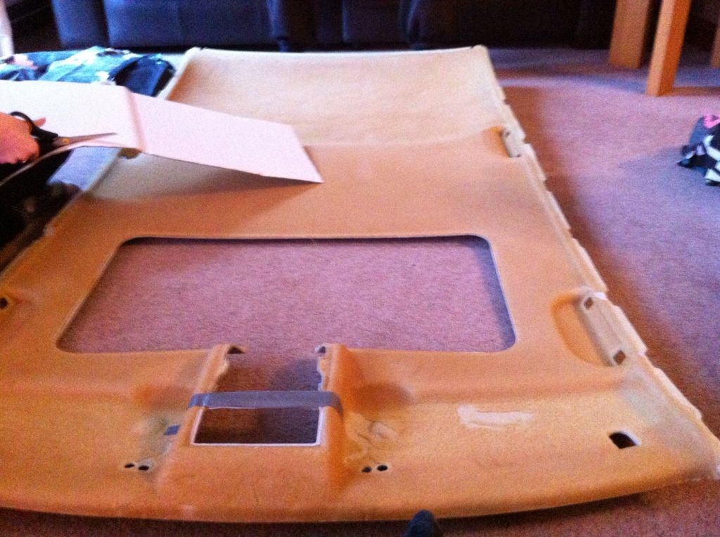

Right
Pull the a pillars away at the top by roof , remove b pillars they won't come off because of the belt but come away , then the big strip comes down at the back between either c pillar , pull c pillars away ,
Remove sun visors and grab hand'els
Then the roof drops down the sun roof seal is on stiff so just peak it down away from the roof liner and un plug roof control switch ,
Remove liner out boot
Remove the interior light unit of the liner .Pull all old cloth of liner but leave foam ,
Stick new material down and make loads of slack around grab hand'els as they need to screw up without splitting material
Glue round the back aswell by a few cm so it doesn't fray on edges you can see ,
Go in the car the slider for the roof comes out the rear , remove the smtwo stops and it just slides out the back and trim that / be Carefull with this you can't fold the edges over but you can only see 90% of this panel when refitted
Then refit and thank me later :)
