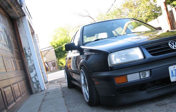

just found this pic for you. this car has 16" wheels with ET18 front and ET13 rear. and it has the plastic arches fitted
although that does look like more poke on the front that ET18 would give. i had ET20 on the front of my mk3 and it was pretty flush. that looks more like ET-18
« Last Edit: 01 October 2012, 14:50 by stainesy »

« Reply #8 on: 01 October 2012, 15:01 »
Car above is only 2mm different to mine and I bet that's had arch work.
So you can see that mine has had serious arch work to make them fit.
I rolled the lip then pulled them out. Say pull but its more pushing lol

« Reply #9 on: 01 October 2012, 15:04 »
Stainsey your wheels weren't 8" though. So et20 to yours that where 7.5j would sit further in
