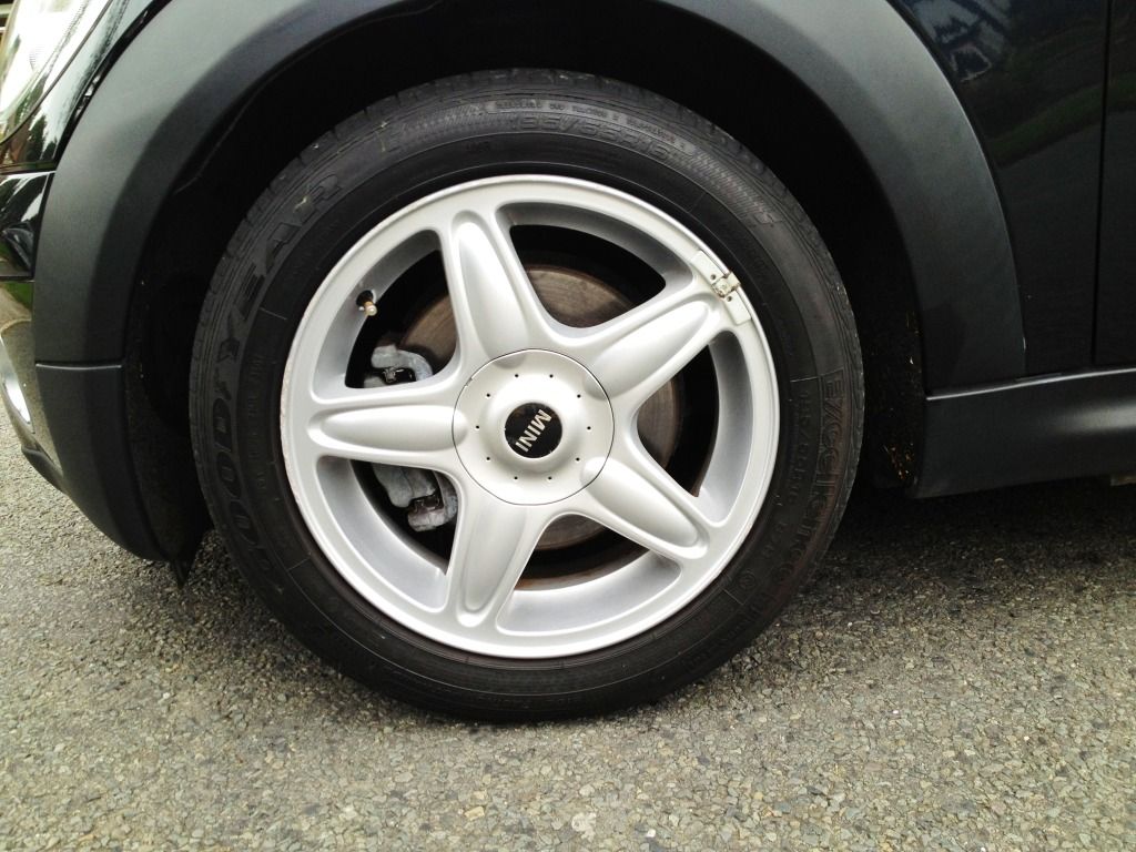

Once washed off i started on the wheels. Used BH SHD on the tyre walls and BH Auto Wheel on the alloys.Used a stiff bristle brush on the tyre wall and a DJ wheel mitt and detailing brush on the alloys.

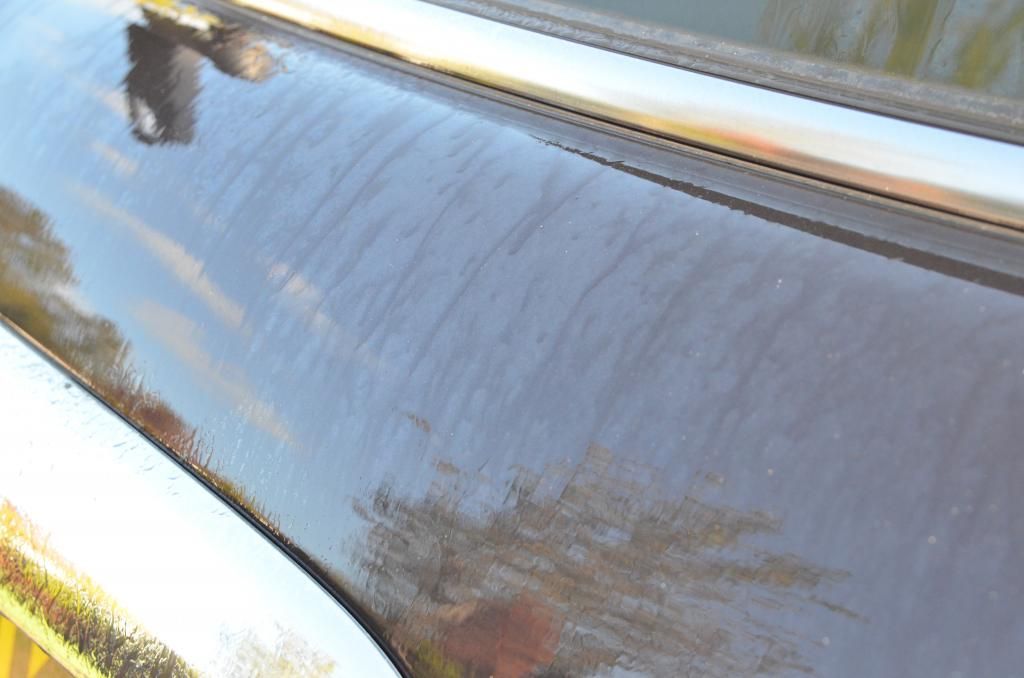

Next i used Iron X to remove all the fallout on the car. Was a bit hard to see on a black/blue car.

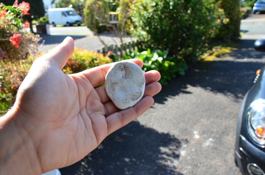

Next it was onto claying the car with BH regular clay bar. As the instructions said i just sprayed the car with water as a lubricant but i would recommend using a lubrication if your not going to polish the car afterwards as it will mar the plaint. A lot of contaminates were pulled out the paint!! the paint now was like glass. very smooth to the touch.

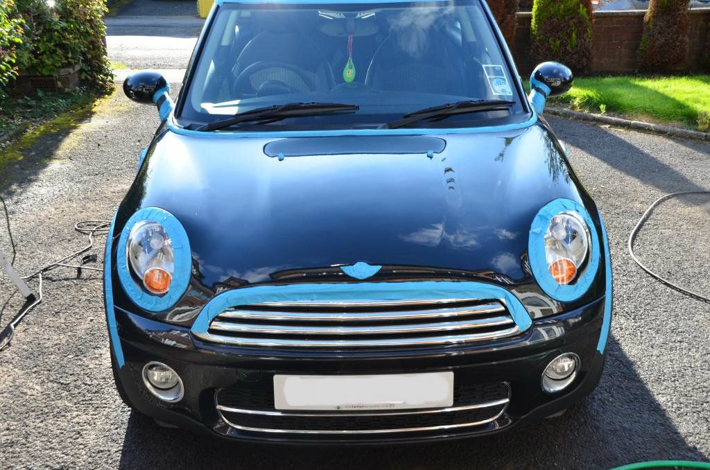

Now it was onto the taping and even tho the mini is a small car it has a lot of plastic all over it so i had to make sure everything was covered so this took some time.

I then remembered that i needed to do the wheels so put came the PB Wheel Sealant and a cotton applicator pad! Easy to apply and easy to buff off so a delight to use. Finally it was onto dressing the tyre walls. SN Tyre Dressing and a applicator. this was left for about 20mins then was buffed off with a cotton cloth!

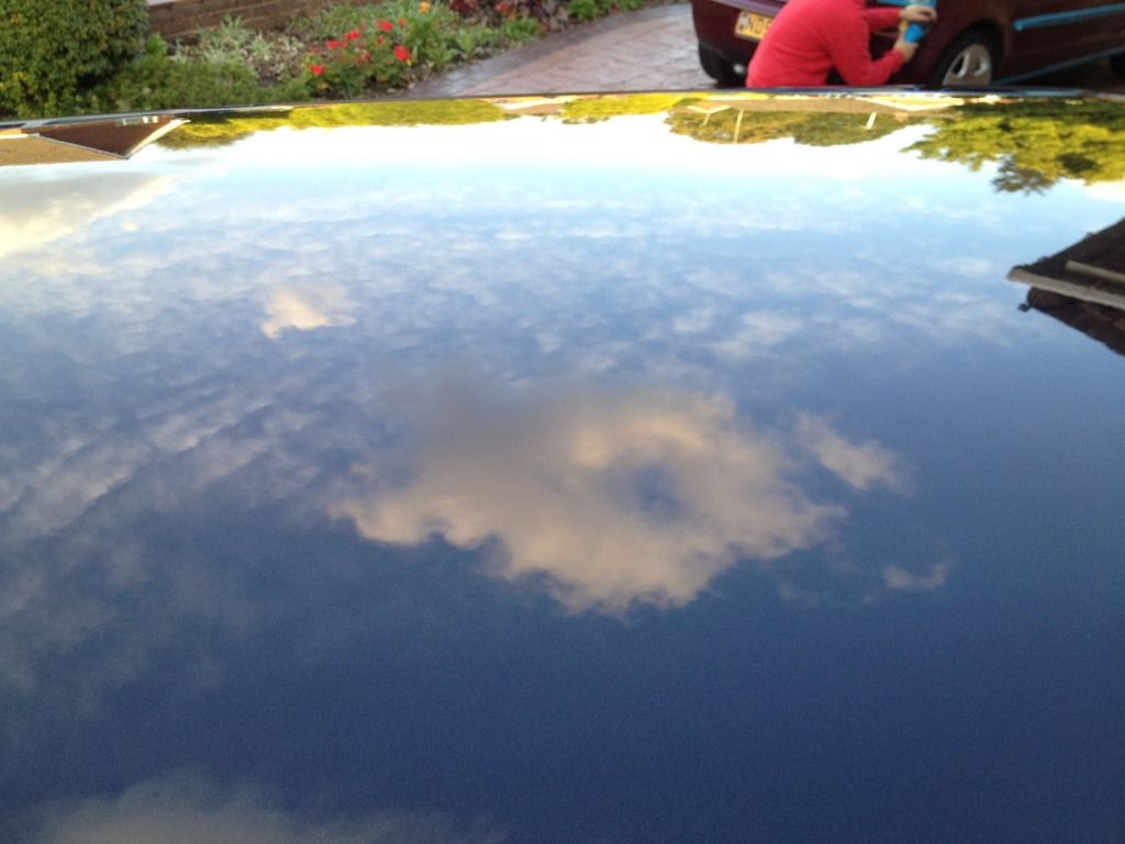

Here are the final few reflection shots

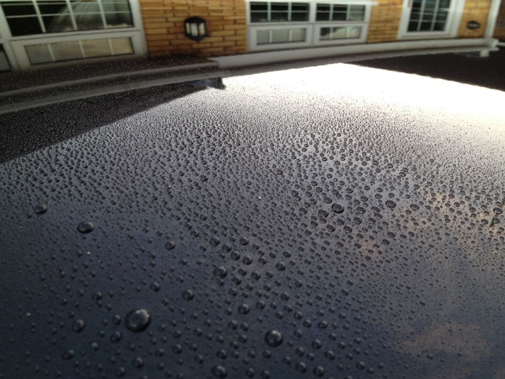

And finally a beading shot

you could save your self a bit of time with taping by using a bit less..
for example, the you don't need to use as much on the wing mirror.. and its only there to stop you burning plastics with the pad/edge of the pad
and if you're doing it outside then it can be easier to only tape a panel as you are about to do it in case you don't get round to doing the whole car that day or if rain or something stops play
