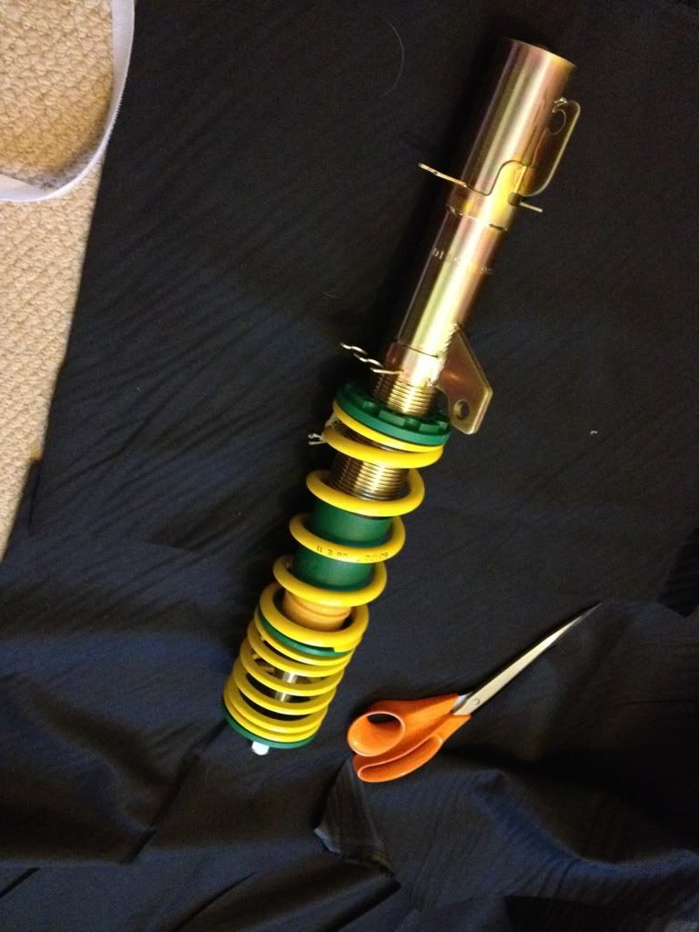

Take some of these  :cool:
Mix it with some of this  :whistle:

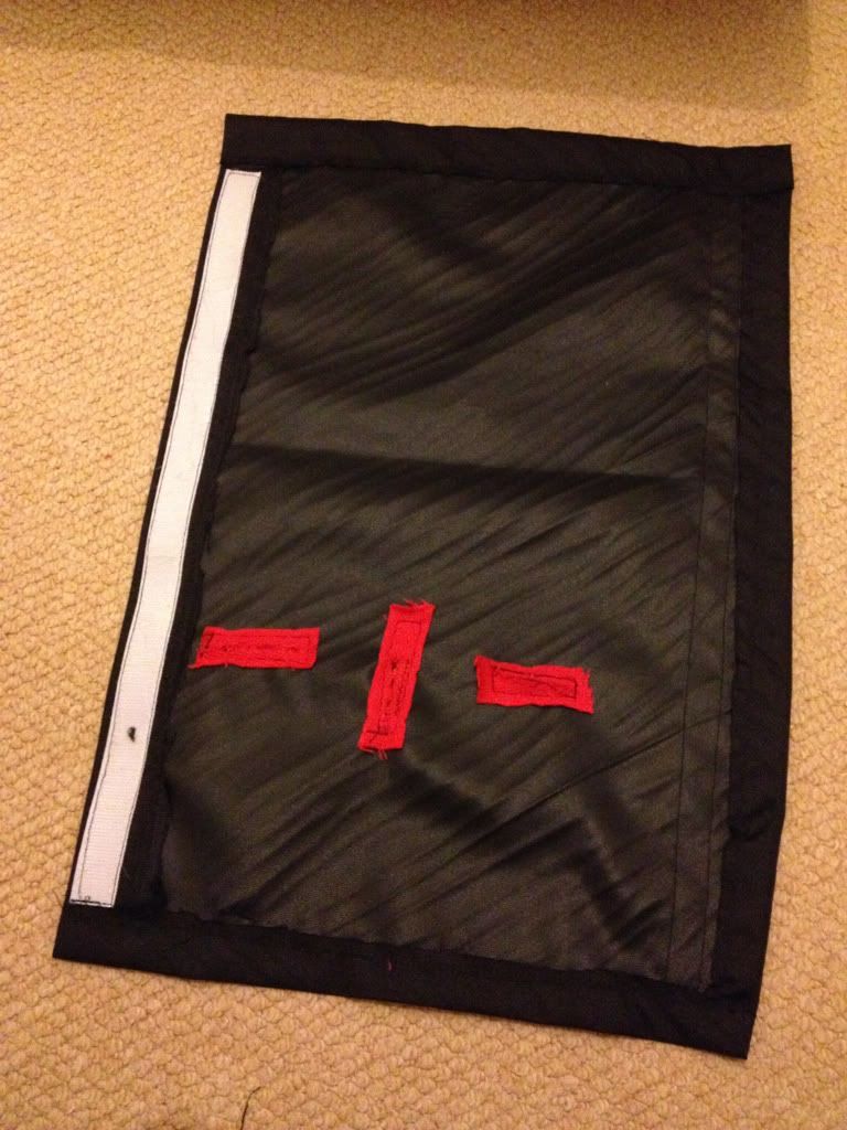

Add some string and velcro

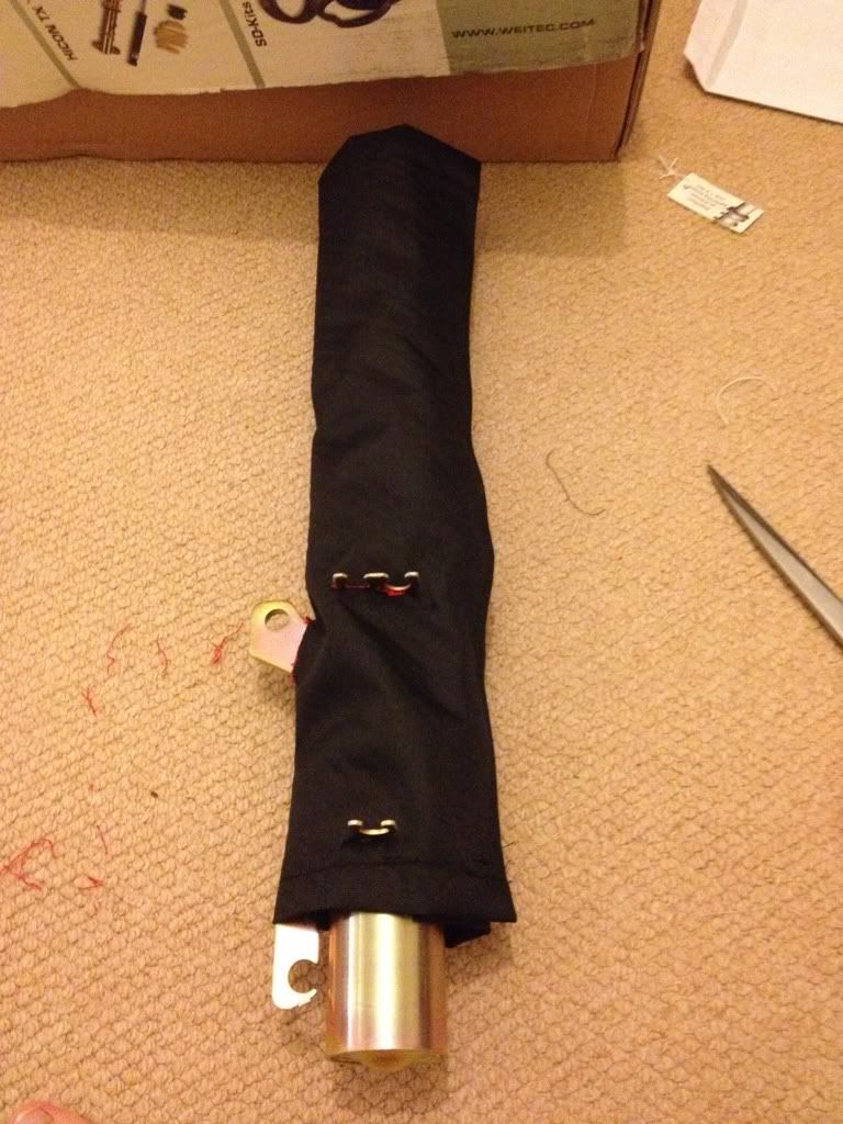

Put it together  :grin: :cool: winter protection booom ! Just need some cord to go round the ends and its done

very nice a rugby sock is another way to do it  :cool:

rugby socks stop all the crap only thing is they are a bit harder to take off  :grin: stops the coils getting corroded tho  :cool:

Cully understands ! Rugby socks would work but cotton would wear quick this stuff really strong and is removable without taking scissors to it. Ive just spent 400 quid on something and with the sh!t weather we get i think there worth £10s worth of fabric and a bit of time !

good job ad mate was thinking of doing mine a while back but chances are they are already fooked  :grin:
it will save quite a lot of the crap from building up on them only one suggestion is to try and cable tie the bottoms tighter to the stop the crap from going up and under if that makes sense  :cool:

Ahhh i didnt even think of cable ties  :laugh: i dont understand how they wont last to be far unless the wheels rub on them !

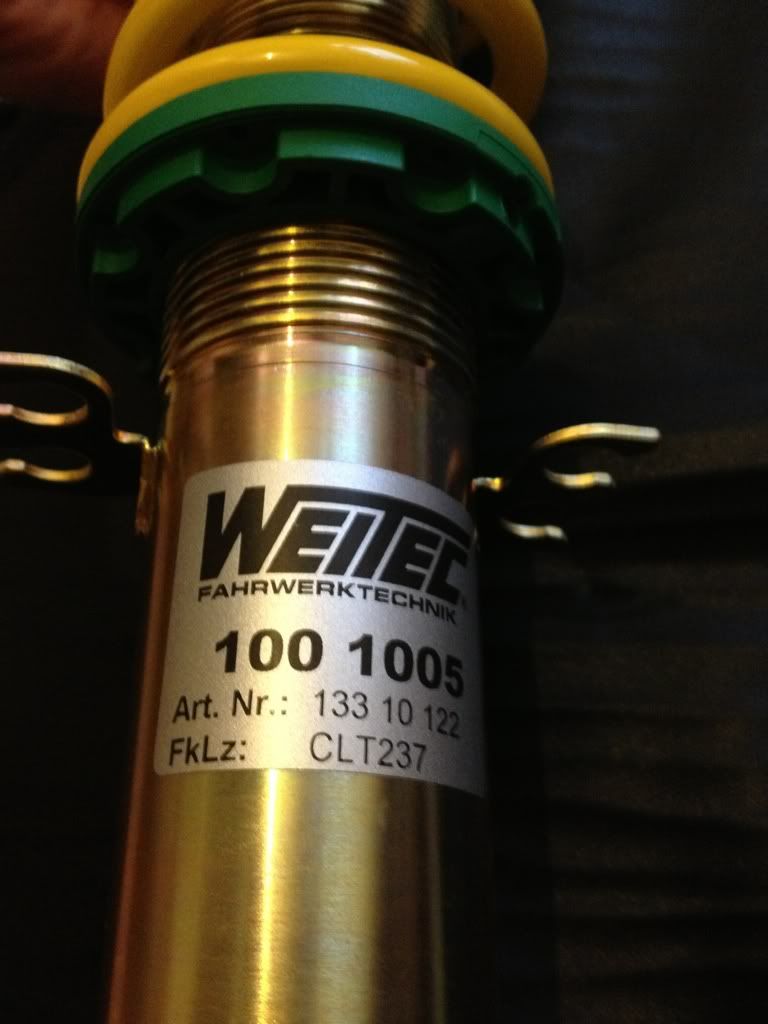

I will also be putting ptfe ??? Tape round the exposed threads.
This may seem all abit extreme but as i said £400 is alot of money
