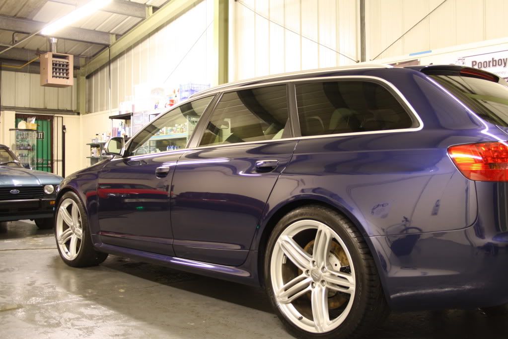

The car driven up from London for me to work on so was pretty dark by the time owner arrived at my unit. The was then given its first coat of snow foam whilst this was dwelling I went round the car using APC in a foaming head bottle cleaning the fuel filler area and various gaps and grills. The snowfoam was then blasted off with the pressure washer, and then the car was given another coat of the same mix snowfoam and the car was washed using the 2 bucket method with grit guards in both buckets and a Carpro lambswool wash mitt.
The car was then rinsed off using an open ended hose and I then went round the car with Tardis which was left to go to work before being wiped down with microfibre clothes. The car was then given a coat of Ironx again left to do its stuff before the car was washed down using the pressure washer.
The car was clayed using citrus bling and water mix (10 to 1) and a Bilt hamber soft clay bar which helped to pull more contaminates from the paint work it was then rewashed using the same method and dried using the woolly mammoth.

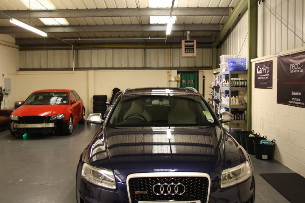

Some photos before I start

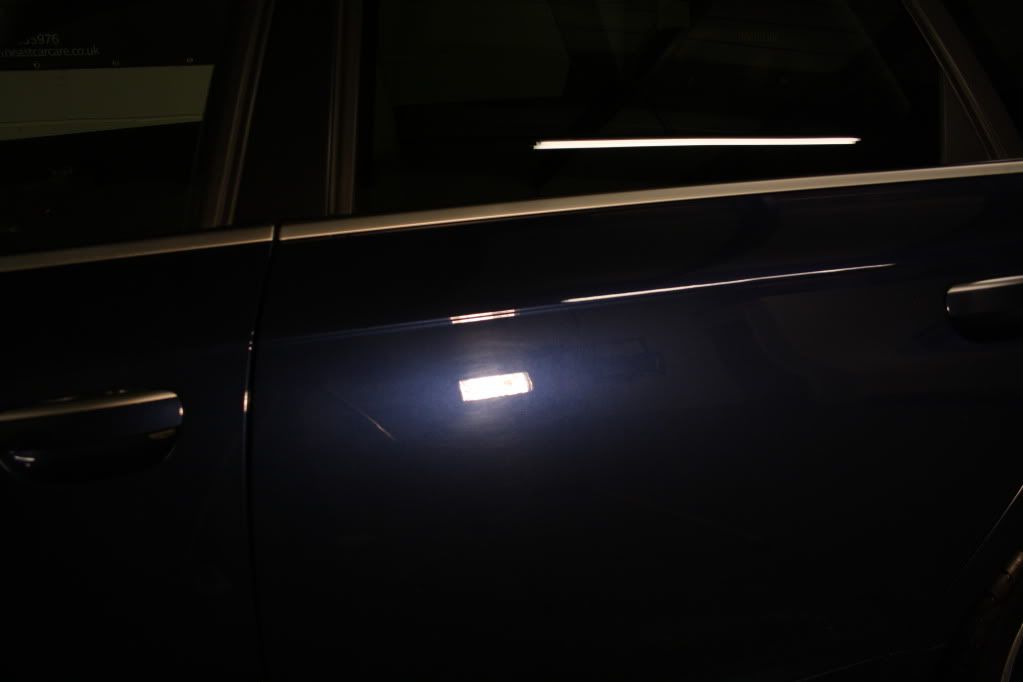

I then taped the car up and went round with various yellow 3m pads and Carpro Fixer polish, each panel was given a wipe down with Carpro eraser after polishing to check finish and remove any polishing oils.

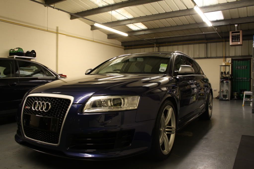

I then went round the car and applied a coat of Chemical guys Glossworkz Glaze using the DA and the lake county pad which was left before being buffed using Uber buffing towels.
The car was given 2 coats of the Chemical Guys Celeste dettaglio v2 wax leaving wax to bond for 60min and approx 60min between each coat again buffed using Uber buffing towels
The plastic trim was dressed using Carpro Dlux which is a cracking product which a little goes a long way and gives a stunning finish.
After this I cleaned the glass and gave them all 2 coats of Autobrite repel
The alloys were sealed using 2 coats of Chemical guys and dressed the tyres using the Valet pro tyre dressing.
Exhaust’s where cleaned up using Auto Finesse metal polish and 00 grade wire wool
For the beading fans
Lots of finished shots lol
