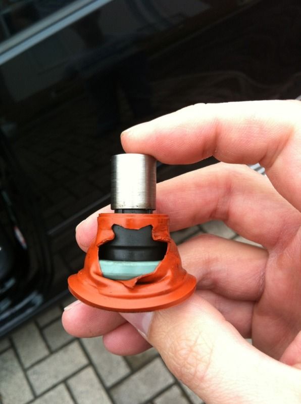

Bit of an update,
Took the car in today, they have removed the DV and its split  :smiley:
So a nice easy repair by the sounds of it and she should be back to normal again  :smiley:

i think yours has lasted well, mine went on the rocco at just under 30k when on stage 1 having not long fitted the ITG, i went rev D then but believe there is a new one which is doing the rounds, pain in the a$$ to get to

Not sure how bad mine has split until I see it tomorrow,
I am on 38k now and been stage 2 for about 20k and loads of Trackdays, so as you say don't think it's done too bad  :smiley:

Heres an example off a MK5 GTI
Bloke who had the car had no idea it was mapped until he replaced it  :whistle:

Mine has a version G I expect most mk6 have this one still crappy though.
It's a peace of piss to change don't know what you are all complaining about   :undecided:
Neil,
Glad its somthing so simple, I thought that's all it prob was.  :cool:

« Reply #19 on: 18 September 2012, 18:00 »
Just picked my car up and what a difference  :laugh: :laugh:
Must of been split for a while and I have just got used to it  :sad:
It flys again  :smiley:
Old one
new part fitted
