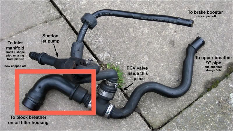

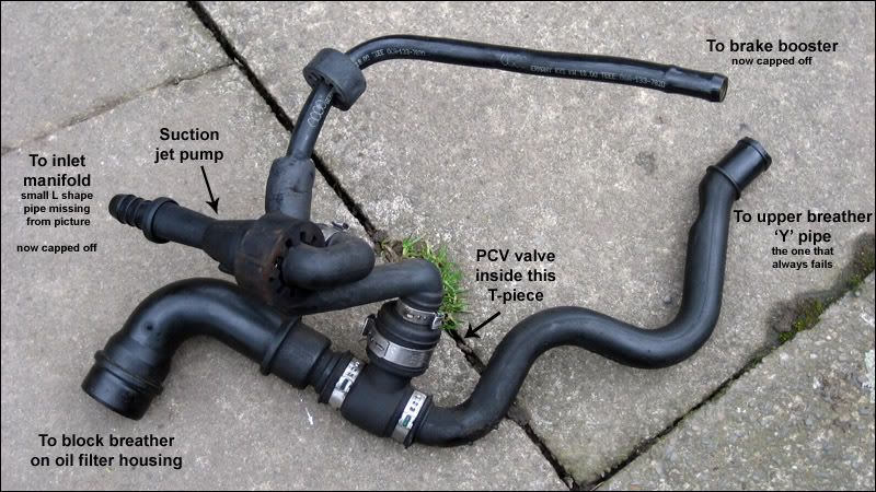

oki fellas, i will start off by saying if you are like me and follow the how to guide given by the ukmkiv forum you wil start to realise the system you remove is slightly different to our AUQ blocks.
they show you that you remove this:
but what the AUQ looks like is this:
with this bit as well:
i found this out the hard way, as i took out the piping that was linked to the AUQ pcv system what seemed to look very similar to the one on ukmkiv forum and i ended up with smoke pissing out of the back of my car :( .
all you have to do is remove the pcv system i have shown and tie it in with the ukmkiv forum 'how to' . this is what i have done and no smoke this time even taken her for a good 50mile test drive

this is the agu pvc pipe work
