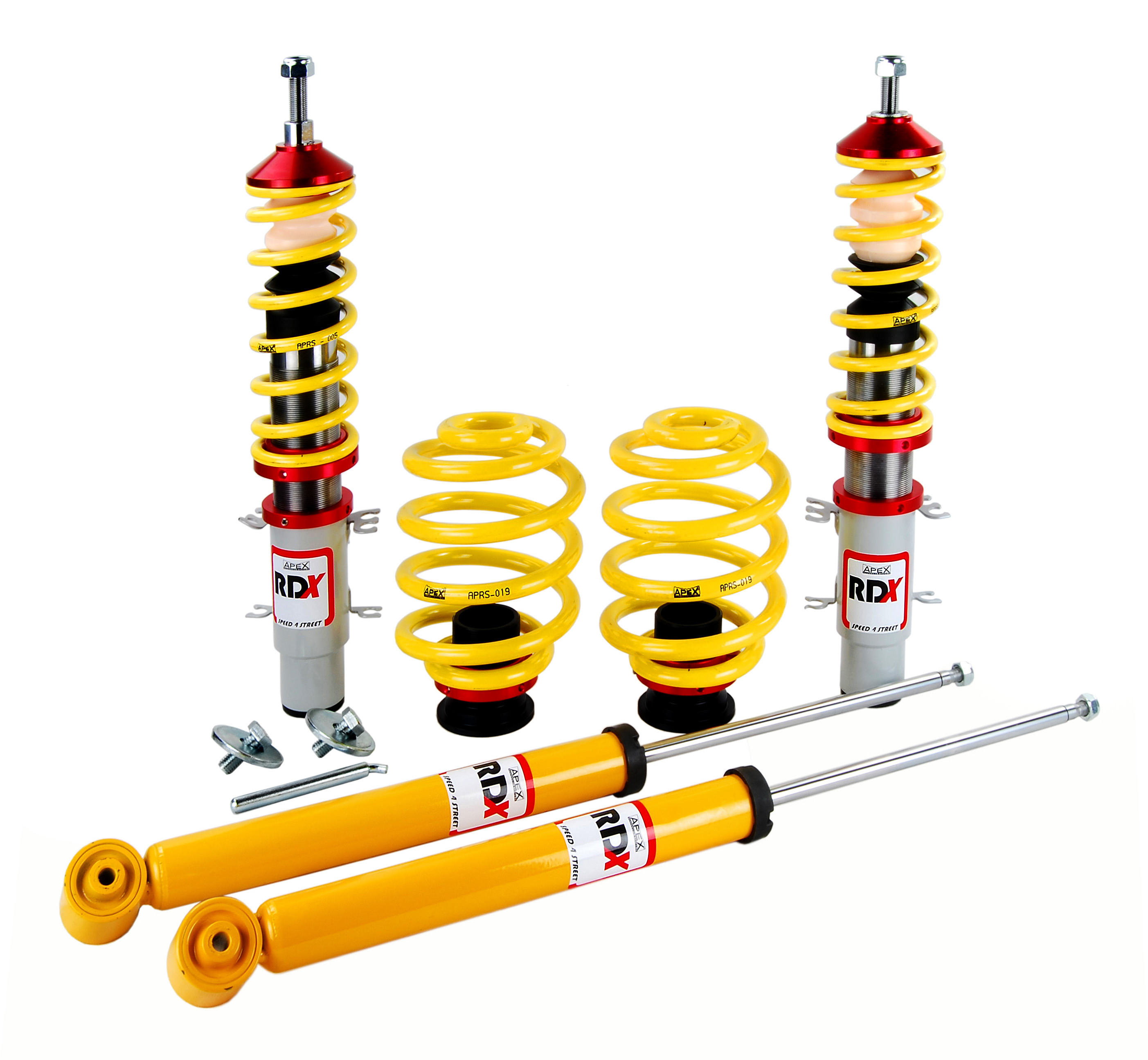

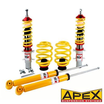

So spent today trying to get the stance right,got the fronts as low as they will physically go, its a weird setup where the threaded section of the damper which has the adjusting rings is actually the bit that sets the height the whole unit turns and lowers into the hub,so when it stopped turning i reckon that means it is at its lowest,then the higher adjuster ring sits under the spring and that sets the damping rate(bouncyness) so i can't see how it can go lower,the rears on the other hand just can't figure them out at all,i'll attach pics to see if anyone can help

see that thing with the threads on it for the ride hight on the rear pull it out. Will see you sit lower.

http://www.prodigymotorsport.co.uk/catalog/images/apex/apex_rdx.jpg
so the little black bit under the springs in the middle your saying just remove the whole bit?
Offline cullygti
  • Posts: 3,888
Re: Stance
« Reply #3 on: 08 September 2012, 17:57 »
yes and it will be lower and you will not have any adjustment then  :wink:
yes thats the bit, BUT its down to you to do it or not.
