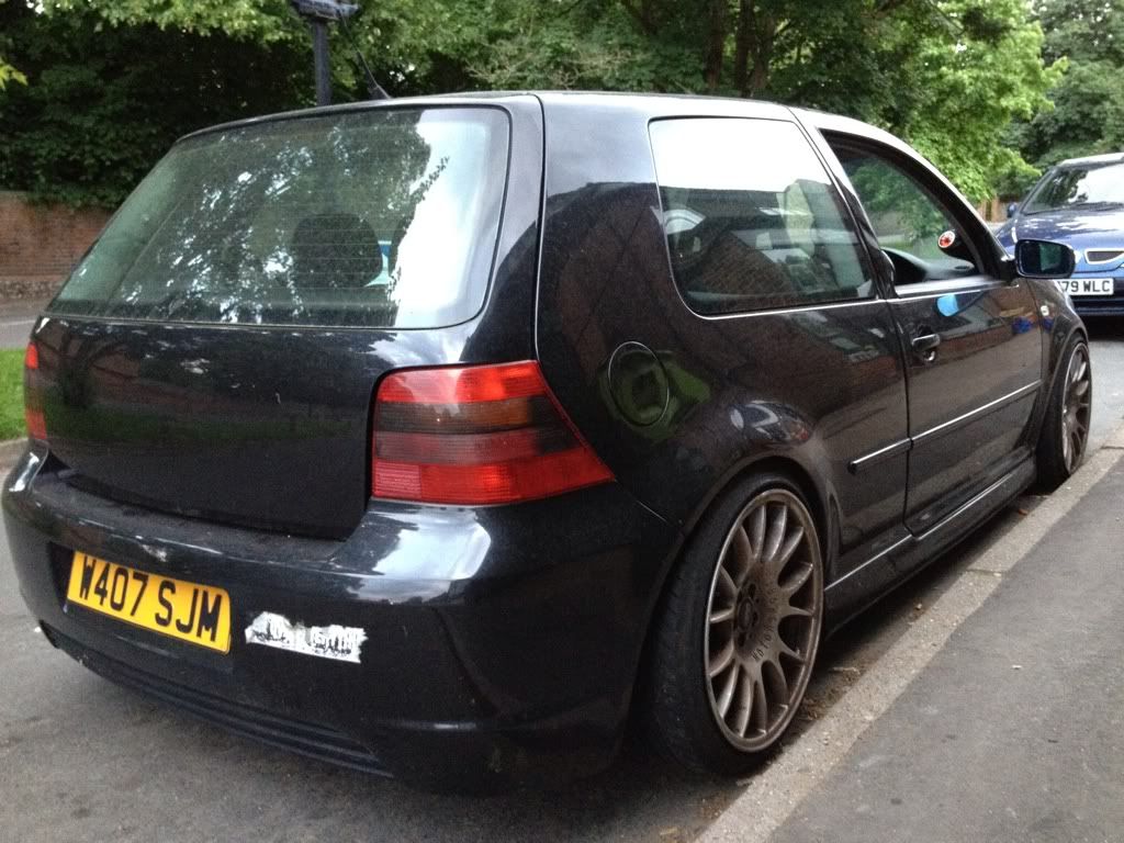

Mines out and slammed on the deck and doesnt wallow about.  Seems fairly planted tbh.
