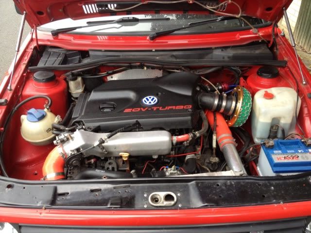

This is my engine bay:
Spec:
AUM 180bhp 20vt
Im knowledge of the 20vt engines isnt very good as yet as ive came from the darkside (Diesel).
I just have a few questions about which direction should i go:
I have been looking at doing a k04 upgrade but i see gt28's and gt30's. What is the difference in power and what modification should i do to support these? Also i am currently running a 'rod box' so should i upgrade this to a 20vt gearbox? What would you recommend me to do?

AUM are all 150bhp buddy.
Depends what sort of power your looking for?
You have a K03s and tipically stage 2 k03s with every mod thrown at it would see around 240bhp 270lbs+
Or you could go K04 and relentless manifold and alot of supporting mods will get you 300bhp 270lbs+
Or even bigger power would need big turbo but youl need engine internal upgrades as youl be throwing rods out left right and centre lol  :grin:
Good luck and welcome to the forum
1.6-1.8t AGU K03s, Forge actuator, Forge 007p, turbo back exhuast, Ths front mount, Catch can, 5 piece silicone boost pipes and creation sports tip. Stage 2 atm 232bhp 270lbs. Waiting for custom mapping :-)

IN a mk2?
AS jamie said.  Personally id go stage 2 k03s.  far better power band/delivery than k04.
