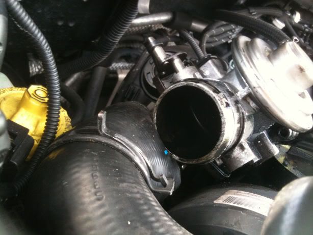

My brother is questioning whether it is the turbo or this little rascal:
Whatever that is is caked in oil. He says the signs still seem to point towards turbo that's gone, but he's questioning this due to it being caked.
Your view?

Thats the EGR valve, was the pipe like that or did he take it off? When the turbo goes it will pump oil all round the intake system so all the pipes and intercooler will be caked in oil.
I put a recon on mine last year. All parts cost £600 and then £300 in labour. Done about 25k on it now and its been fine (touch wood :lipsrsealed:)

Nah, the pipe wasn't like that - he'd taken it off for that photo.
His boss is on at him about it now, which is not going down well. Boss has said to check whether EGR valve is stuck open. He's also told him to take some pipes off connected to the turbo (exhaust was one of them & i can't remember the name of the other). I don't know what he's then supposed to do. Start it i think? Boss was going on about the air filter & some sort of pre-filter.

Oil supply and return pipes, new air filter, oil and oil filter.
Dont know what his boos is on about. Take the pipe off to the intercooler and see how much oil is in there.
